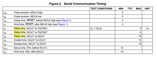

Hi TI,
I need one help regarding the timing constraints given for the Serial communication of TLV320AIC24K. Here minimum time for Delay time, SCLK↑ to FS/FSD↓ is not given. Also for Delay time, SCLK↑ to FS/FSD↑ not given. Similarly, maximum Setup time, DIN, before SCLK↓ , and maximum Hold time, DIN, after SCLK↓ are not given in the datasheet. What value we need to consider for them, can you please clarify this missing information? We need this information to add a timing constraint for FPGA. I have attached a timing information image for reference.

  • Hi Deepeshwar,
    This device is considerably old, this may be the reason it is not fully specified like more moderns devices. I would say you can use the same timing schemes as other devices like TLV320DAC32.
