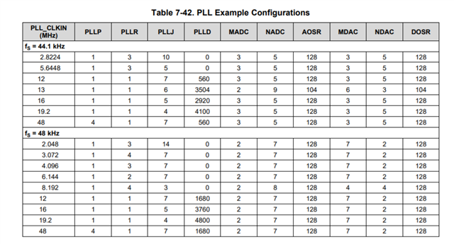

  • Hi Ravi,
    I apologize for the delayed response.
    I am trying to work out the timing for your chip. Do you happen to know the frequency of the MCLK Waveform applied to the chip. I remembered you had measured it before but i dont now see it in the thread
  • Can you also check if this clock changes after applying the aplay command
  • Hi Sanjay,
    I have measured the Frequency of MCLK, it showing is Zero before & after aplay (aplay -v LRMonoPhase4.wav ) command.
    Also, i have measured the following clk as well and the values are WCLK is 19.80KHz & BCLK is 633.3KHz. This was already captured and you aware of this.
    So, please let me know what modification i have do it next.
    Ravi V
  • I have taken a look at both files for before and After command execution. I notice register 0x1B sets up the device to give WCLK and BCLK as an output. This is done in Master Mode. But to work Master Mode needs
    an external clock input MCLK.
    From your observations I see that there is no external MCLK coming in.
    I feel  there would be somewhere settings for the I2s connection from the audio source that need to be properly setup . To make 48K work  any of the below clock values need to be made from the source.
    For example 6.144 Mhz  may be one option for MCLK..
    Please look within your board for the pin here the MCLK originates. perhaps that will help you locate how to set it up in firmware
    My experience is mainly on the Hardware side and I can help you with Hardware issues and Codec I2C settings. I am not a specialist in the Linux sphere .
  • Hi Sanjay,
    If i want to give external clock to MCLK means what are the changes i have to do.
    And How much frequency shall i give to MCLK for solving this issue.
    Also, can you please check the schematic and let me know is any correction is there?
    Please do the needful.
    Ravi V
  • You can set up device in slave Mode. Here we provide BCLK,LRCLK and Din from an I2S Source.
    The source can be 48Khz,16 bit i2s audio. The Source shall give LRCLK of 48kHZ and BCK=48K*32=1.53MHZ.
    This should be checked with a CRO.
    You can load the below script on I2C. Device address is 0x30.
    Sound should come on class D Output.
    let me know if it works.

    I have some update for you: I am getting the audio .wav file some what better, but not accurate.
    I have updated the values as per the PLL example what you have mentioned above and  with 0x0b & 0x0c optimised value
    From kernel level, i am able to set the 0x0b = 1and 0x0c = 8 registers value. Also, am getting the following freq during playing BCLK=1.28MHz, WCLK=40KHz, MCLk:NA
    /* 44.1k rate */
    {12000000, 44100, 7, 0560, 128, 1, 8, 128, 8, 2},
    {12000000, 44100, 8, 0560, 128, 1, 8, 128, 6, 3},
    {12500000, 44100, 7, 2253, 128, 8, 2, 128, 8, 2},
    /* 48k rate */
    {12000000, 48000, 8, 1680, 128, 1, 8, 128, 8, 2},
    {12000000, 48000, 7, 1680, 96, 1, 8, 96, 5, 4},
    {12500000, 48000, 7, 8643, 128, 8, 2, 128, 8, 2},
    The problem is how to confirm that is this standard 1x Speed?
    Note:
    The above script we are able to execute via i2cset command and not from the script.
    Please help me the settings to update in the tlv320aic31xx.c, it is possible to update.

  • Hi Sanjay,
    Based on the above setting of 0x0b & 0x0c, still 0.10x speed differnce is observed. But, i am unable to fine tune 0.10x percentange and i have no idea  whch register will arrest this issue.
    Can you help me on this.

  • The I2C Settings i have sent  are to configure the device for Slave mod with 48Khz Input.
    The LRCK and BCK are inputs to the codec chip and we can  leave the settings in the chip as i have sent . The PLL should be correctly set up for 48Khz
    This means that the audio source (The audio processsor that is taking a 48k file and making data) should be set up to make an LRCLK of 48K and a BCLK of 1.53 Mhz.
    You will have to find the code which adjusts the LRCK and BCK frequency coming into the codec chip. Once this is set to 48Khz and 1.53Mhz the sound shall be fine.

  • There are 2 aspects to this.
    1, Setting the registers in the coded with the I2C Codes i have sent.
    2. Providing a correct incoming timing corresponding to 48K so that LRCLK=48K and BCLK=48K*32 are fed into the chip. You will need to find the settings in the source (Not the Codec) which can do this.
