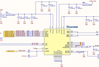

  • Audiocodec_HWDetails.pptx
    I have attched the HW details for your reference.
    No we are not using PC. The Alaram.wav file is avail in the embeeded linux directory in the imx8m board, from there  i am execution/playing the audio file using "gst-play_1.0 Alaram.wav" command.
    I hope am clarified the connection details & playing execution details.

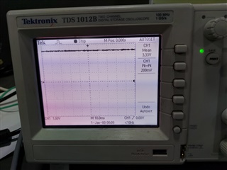

  • Hi Sanjay,
    Do you still get these waveforms if you dont run the wav file?
    There is no clock pulses, its pulled high.

  • One question.. With this change the source should now generate LRCK ,BCK  from the processor side . In the past the codec was creating the timings.
    Is it possible using a play command try to run 44.1Khz and 48Khz and see if LRCK and BCK show 48k and 1.53Mhz. Do not worry about the sound
  • Hi Sanjay,
    After the change, we have checked the freq, it same as privious freq. Its not working.
    I have tried to set  the i2c setting ( 0x0b 0x81 and 0x0c 0x86)  in the console window and the playback speed is good. And also, i executed in commands during bootup time during kernel booting time, it was not working.
    So, i need your suggestion to set the clk & reg setting in .dts file and tlv320aic31xx.c file. Could you please suggest a solution.
