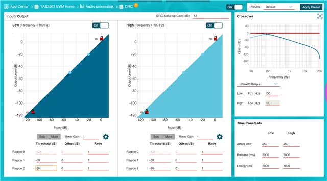

    I am interested in adopting your DRC settings in an attempt to increase output volume without causing distortion. Can you help me understand what you mean by "TI recommends a level of –20 dB with a ratio of 4:1 for the threshold portion of DRC"?
    I am looking at the DRC configuration and am at a loss at how to apply your suggestion.
  • Hello Tianyu,
    My apologies for not being more clear before. The values within the Threshold, Offset, and Ratio columns can be experimented with. However, above your high frequency graph, there is the "DRC Make-up Gain (dB)" section. It is recommended to keep this between 0 and 2 dB. My first recommendation is to change the Region 2 row on your high frequency graph to [-20, 0, 4]. Try experimenting with that, and if it still is not sounding optimal, let me know.
    There is an article about Smart Amp tuning/DRC guide that you may find helpful: https://www.ti.com/lit/an/slaa751/slaa751.pdf?ts=1628176645489&ref_url=https%253A%252F%252Fwww.ti.com%252Fproduct%252FTAS2563
