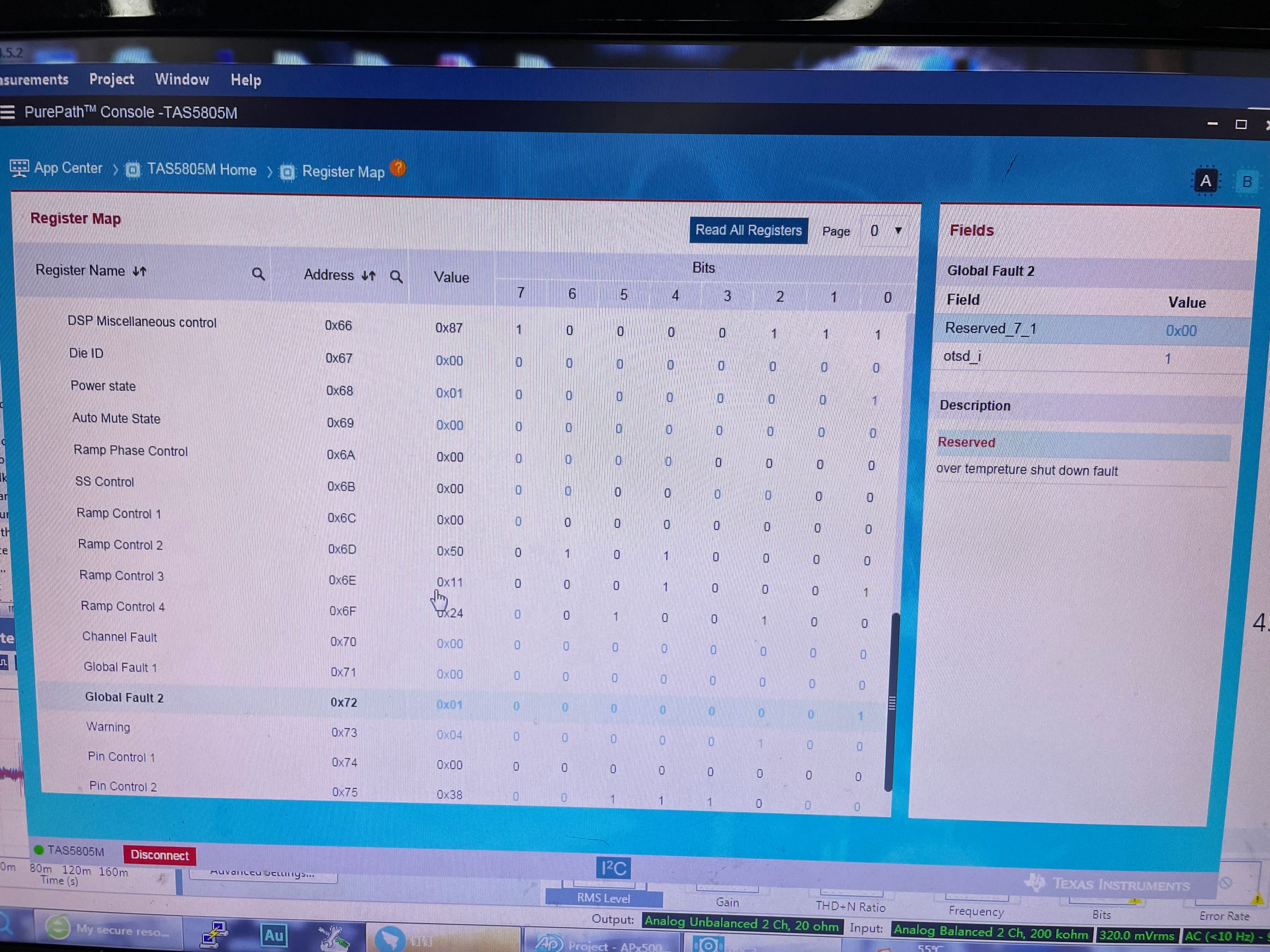

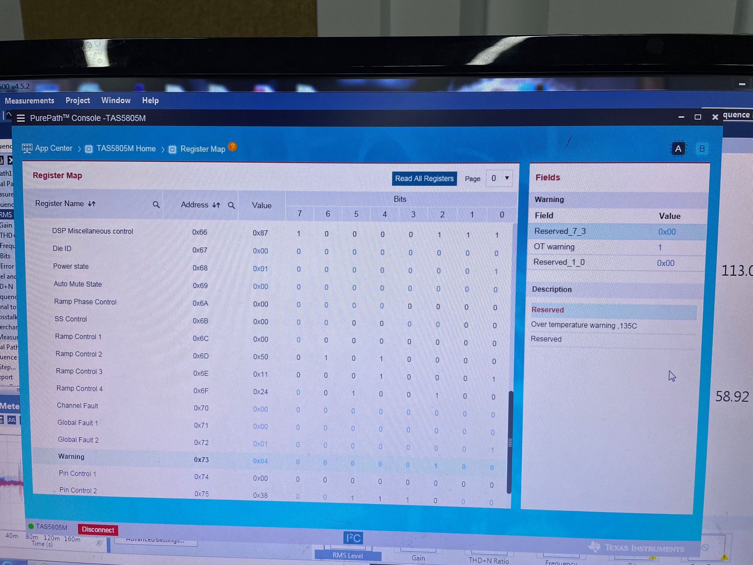

Hi Ti Team,
My customer uses TAS5805M for stereo 2.0. When the power reaches 12W, it will be temperature protected in a few seconds. Can you help me see the reason? Schematic diagram and Layout below 。
PVDD=15V  RL=4Ω
TAS5805 schematic
Layout
AV-MPEG-27G-V0.2-Final_20210811.pcb
PPC3 readout temperature protection
  • Hi Switch,
              There are ways to improve thermal performance:
               1. Try to use lower switching frequency and bandwidth
               2. Improve layout as datasheet recommends.
               3. Use larger inductor
               4. Use 1SPW modulation
    Leon
