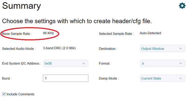

  • Hello, Shadow,
    I found when I dump to the header file, here is a setting called "Base Sample Rate", like below picture
    is this setting related to i2s LRCLK frequency?
    Should I make sure this setting needs to be the same as i2s LRCLK frequency?
    thanks
    BR
    Teddy

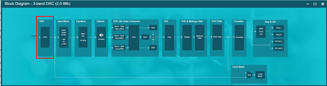

  • Hi Teddy
        This "Base Sample Rate" is decided by the Process Flow you've chosen. It is not necessary to set the LRCLK the same as it, because we have SRC to auto detect the input sample rate. The SRC will convert the LRCLK frequency you use into base sample rate inside of our DSP.
