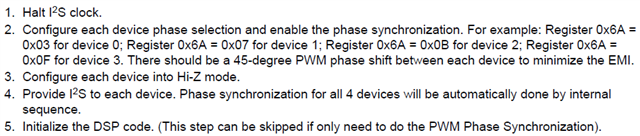

We would like to change RAMP_PHASE_SEL when TAS5805M is active because to confirm the effect of each mode.
We try to send via I2C to change PHASE mode.
But It behaves unexpectedly in us.
・Phase change occur when I2S_SYNC_EN is disable.
・The actual parameter I changed are different from set value every time
Is it not supposed to change value when TAS5805M is active ?
