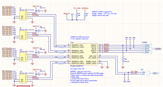

We are testing a new PCB prototype using the PCMD3180 codec and 4 digital PDM microphones. Each microphone is connected to one of the GPI inputs as shown in our schematic:
We are using the shared upstreamed linux driver for TLV320ADCx140, following the details from this forum post: https://e2e.ti.com/support/audio-group/audio/f/audio-forum/954542/faq-pcmd3180-is-there-a-linux-driver-for-the-pcmd3180-devices
Our host is a raspberry PI 4 compute module.
We have had some initial success and are able to record sound through one of our microphone channels, channel 1, and the quality appears to be good. We have not been able to record sound through any of the other channels however. We're use I2S for dai format / protocol.
We have the following questions:
1. For our configuration where we have one PDM microphone on each GPI input, does this correlate to using channels 1,3,5,7? Channels 2,4,6,8 are unused?
2. The linux driver indicates support for sampling rates of 44.1kHz and 48kHz, can that driver also be used for 96kHz and 192kHz sample rates?
3. Assuming the use of I2S can only handle 2 channels for left and right for the rPI by default, how do we select which 2 digital microphones are used for the left and right channel of the I2S stream?

  • Hello Jeremy,
    Thank you for your patience, I will need time to review your questions and I will get back to you within 48 hours.
    Carson
  • Hello Jeremy,
    Your assumption is correct about what channels would output given you only have 4 mics attached. In the TDM mode it allows you to select what channel goes into what slot including into either the left or right side of the same I2S slot.
    You should be able to run at any capable Fs rate.
    Cannot really help with actual linux specifics as we are not currently supporting linux debug problems until our Applications team is ramped up from prior team responsible for these parts about linux, which has no timetable unfortunately.
    Carson
