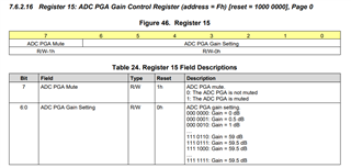

In the datasheet page 41 onwards you will find the register map for this device.
Depending on the audio path you are using you can enable/disable or change the volume/mute or unmute them.
For example input ADC path register 15 or output HPOUT register 65 below, you can set them accordingly:

I2S is an audio interface, you can't use it for I2C transaction.
You need to set the codec registers thru I2C from your host and use the driver provided in the product folder.
Regards.
I have replied and provided an example in the thread above.
As I don't know what path you are using you need to look at the register map and configure them accordingly.
You can also refer to this user guide Appendix H for example of configuring the different path/configuration registers:
