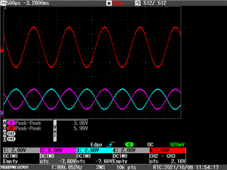

SPKR- (yellow) and SPKR+ (blue) get cut of although the output power is only about 2W according to the measurement.
And the +V5 supply voltage of the amplifier has almost 200mV ripple.

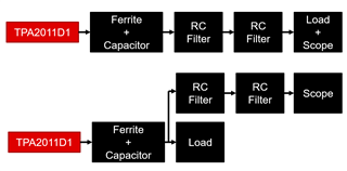

      I think you're using a connection like the one displayed below, on the top diagram. I would suggest to use the connection from diagram on the bottom. Ideally you should connect the speaker directly at the output of the amplifier, even without ferrite+cap, but if not possible you can try this way.
    -Ivan Salazar
    Applications Engineer
  • Hi Ivan,
    Thank you for your reply.

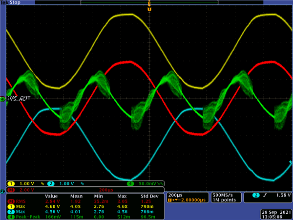

    I am measuring with the following setup which I think should be the same as the bottom one on your picture above:
    I tried using a 4Ohm speaker instead of the 4Ohm resistor I used before.
    With the speaker the output power I measure is even less than with the Resistor.
    We need an output power of 2W which should be not problem for the amplifier when supplied with 5V.
    But according to my measurements I can not reach 2W output power without the output sine getting cut off.
    To demonstrate this I changed R21 and R22 back to 130kOhm and R23 to 62kOhm to increase the gain.
    With this setup the input signal can be adjusted to see the impact on the output power.

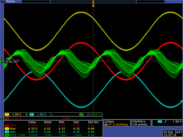

    Yellow (SPKR+), blue (SPKR-), red (SPKR+ minus SPKR-), green (+V5 input ripple)
    The first measurement was done with the input signal set to 75% via windows:
    The output power is calculated with: square (RMS output voltage) / Load resistance = (2.26V)^2/4Ohm = 1,28W
    To get an output power of 2W a RMS output voltage of 2.83V is needed.
    Therefore I increased the input signal volume until the output voltage reached 2.83V (signal set to 85% via windows)
    With the input at 85% the output power is about 2W according to my calculation. But the sine is already cut of at this state.
    Please let me know why I am not able to reach an output power of 2W and still have a proper sine.
    As you can see I also measured the +V5 supply voltage ripple of the amplifier. Is a ripple of 120 to 170mV normal or does this suggest an issue?
    Is my calculation of the output power as mentioned above correct?

    I did the changes you suggested and measured the output signals an power again. There was only a very small increase from 2.71V to 2.73V RMS of the output signal. Over all I don't think this is the solution for our issue.

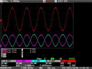

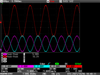

  • Hi Benjamin,
    I completed test with EVM for 3 different loads:
    • 4Ohm
    • 8Ohm
    • 500Ohm
    For higher loads you should be able to reach close to VDD supply, lower loads would limit the voltage drive.
    Please check with different power supplies, and also try changing your decoupling capacitors: you're using 5V supply and 10uF/6.3V, ideally decoupling caps should be rated for 2 or 3 times the DC voltage it will bypass.
    -Ivan Salazar
  • Hi Ivan,
    Thank you for the test results.
    What RC-low-pass filter did you use for your measurements?
    If I see it correctly you also can't reach 2W output power with your 4Ohm setup. Or am I missing something?

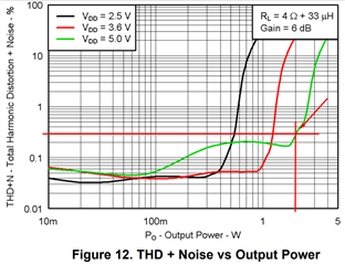

    To have 2W output power the signal has to be about 8V peak to peak or 2.84V RMS.
    It also seems like your output signals already have quite some distortion. According to the Datasheet the distortion at 2W with 4Ohm load should be almost unrecognizable with only 0.3%

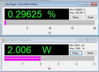

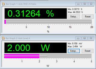

  • Benjamin,
    I just notice my load is not 4-ohm but 2-ohm. Please see below for 2-ohm and 4-ohm test, sorry for the confusion:
    • 2Ohm
    • 4Ohm
    As you mentioned, there is already some distortion (~0.3%) at the positive peak of the waveform.
    EDIT: I'm using AUX-0025 filter for this measurement: https://www.ap.com/download/aux-0025-0040-0100-data-sheet/?wpdmdl=7374
    -Ivan Salazar
  • Hi Ivan,
    Thank you for the update. The second measurement with the 4Ohm resistor helps a lot.
    I was not aware that 0.3% distortion is already that visible on SPKR- and PSKR+. I thought those spikes meen a lot more distotion.
    If it is possible it would be great if you could send me the last picture in a bettter resolusion as it is quite hard to see details on it at its current size.
    Thanks a lot for your support so far.
  • Benjamin,
    Not sure if resolution will be better, but here are the captures attached:
