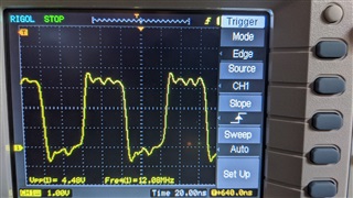

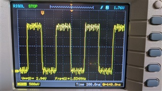

  • Hi Pdjuandi,
    MCLK is provided by the SoM and as you said BCLK and WCLK are provided by the codec as it's configured as master.
    I found the solution for MCLK, so my frequency is 12 MHz, my BCLK frequency is 1.5 Mhz and my WCLK frequency is 48 Khz when I try to play audio by using this command line:
    root@imx8mp-var-dart:~# speaker-test -D sysdefault:HTC2SoundCard
    But I still cannot hear sound on my Headphone and speaker-test stays blocked :
    speaker-test 1.1.9
    Playback device is sysdefault:HTC2SoundCard
    Stream parameters are 48000Hz, S16_LE, 1 channels
    Using 16 octaves of pink noise
    Rate set to 48000Hz (requested 48000Hz)
    Buffer size range from 64 to 16384
    Period size range from 32 to 8192
    Using max buffer size 16384
    Periods = 4
    was set period_size = 4096
    was set buffer_size = 16384
    0 - Front Left
    BLCK 1.5Mhz :
    WCLK 48Khz :
    MCLK 12 Mhz :
    Mathieu.

  • Hi Pdjuandi,
    This is my DIN CLK while I play audio and I have no input on it :
  • Hi Mathieu,
    I believe this DIN is data in and not a clock.
    Nonetheless, the issue still lies in getting the correct configuration on codec. Why the settings got changed?
    Regards.
    Peter
  • Hi Pdjuandi,
    Yes, sorry DATA and not CLK, all the other signals, BCLK, MCLK and WCLK are the same but DIN looks like that.
    Mathieu.
