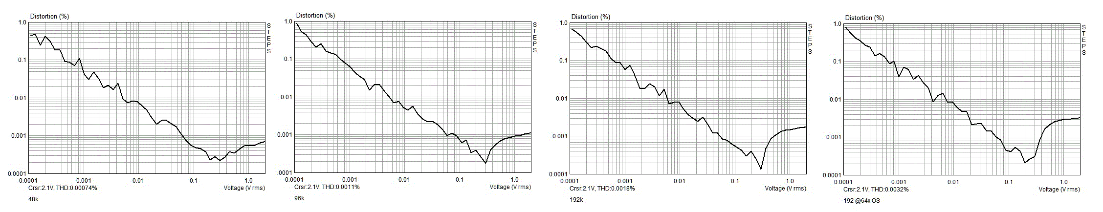

If I lower the output level down from -1dB to -10dB the distortion remains roughly the same, it decreases, but only by a tiny bit. Say from 0.0018% to 0.0015% for a sampling frequency of 192khz and an OS rate of 32x.
If I then lower the output level from -10dB to -14dB, it decreases down to 0.001%.
If I then lower the output from -14dB down to -18dB something interesting happens. The distortion @ all sampling frequencies and pretty much all OS rates just takes a vacation and looks something likes this.

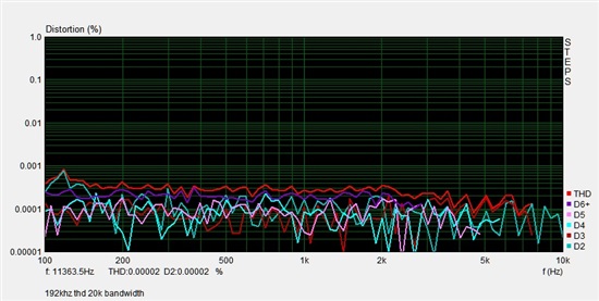

Interested by this I ran a sweep from 100-20khz and came up with this.
Obviously this isn't just frequency related, so probably isn't a result of any inductive or capacitive coupling. Nor would I imagine contamination of an analogue signal line by an a ground current.
