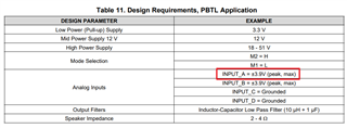

I have a 0.9 Vrms differential signal wich I want to feed to the TPA3255.
And now I wanted to calculate how I need to pre-amp this signal to feed into the TPA3255.
PVDD = 55 V
Rload = 8 Ohm Speaker
I am a little confused about the datasheet of the TPA3255 and its input voltages.
The intro text states 2 vrms
The example tells me +/- 3.9 V max wich would be 2.76 Vrms.
However, when I look to the Analog Inputs electrical characteristics I find this:
The above max input voltage swing of 7 volts would mean +/- 3.5 volts. But the example above uses more input swing. This is confusing.
If I calculate my Vout to swing up to my 55 V Volt rail and using the 21.5 dB Gain from the datasheet the result would be
+/- 4.63 Volts swing -> 3.27 Vrms
Is my calculation correct and I should feed a 3.27 Vrms to each analog input?

  • Hi Muller,
    1、The intro text states 2Vrms indicates when it use with PCM5242, PCM5242 can support 2Vrms in single-ended.
    2、About input voltage range, maximum input voltage swing, peak - peak value is 7V, ignore the examples(+/- 3.9 V)
    3、When you use 21.5dB Gain, the maximum input voltage is +/- 4.63 Volts swing so that can output 55V on load.

  • Hi Muller,
    When PVDD=55V, the maximum output voltage on 8ohm load is about 52V(any channel refer to GND) due to voltage dissipation. The gain is 21.5dB(11.885), so the max input voltage is +/-2.19V(refer to GND), that is 4.38V peak-peak, so the RMS value is 1.55Vrms.

  • Hi Muller,
