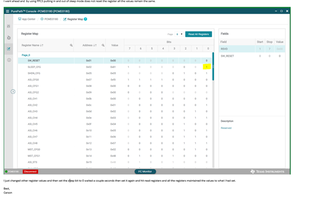

  • Are you taking care for the Below?
    1.In sleep mode, do not perform any I 2C or SPI transactions, except for exiting sleep mode in order to enter active mode. After entering sleep mode, wait at least 10 ms before starting I 2C or SPI transactions to exit sleep mode.
    2.After entering active mode, wait at least 1 ms before starting any I 2C or SPI transactions in order to allow the device to complete the internal wake-up sequence.

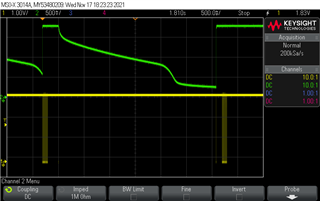

    • At ~1.5 sec, a very short current pulse is observed, its width is around 100usec, peaking at around 20 mA. This pulse then follows every 1.33 sec.
    • If sleep time is large enough to include this pulse, the registers are lost.
    • No voltage drop is visible on any of the lines (e.g. SHDNZ).
    • I have excluded other circuit parts causing the current pulse.
    • This current pulse seems to be the charge pulse to retain the registers. The pulse is not there if I use hardware sleep with SHDNZ.

  • Is this pulse repeated as long Oankaj the commands are written r for  in sleep mode?  Does the pulse stop when you are woken up again?
  • Yes, the pulse repeats as long as being in sleep mode. When woken up, the pulses are not coming any longer. They are also not present in HW sleep mode (SHDNZ).

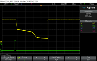

    The AREG line is measured to be 1.7857V in active mode, and starts falling slowly after the sleep command.  It falls below 1V at around 1.25s after the sleep command. On the wakeup command, AREG jumps back to 1.7857V immediately. See green curve on the attached scope recording.

  • We follow the typical application as shown in Fig161, so VDD=3.3V and AREG_SELECT=1. The sleep command is 0x80 and the wake command is 0x81, written to the SLEEP_CFG register. We are not setting AREG_SELECT to 0. The 1 MSB (0x80, 0x81) of the sleep and wake commands are the AREG_SELECT bit=1.
    The AREG pin voltage is indeed falling in SW sleep. The internal regulator keeps it at 1.8V before the sleep and after wakeup.
    Is the internal AREG regulator expected to hold the 1.8V on the AREG pin also in SW sleep mode?

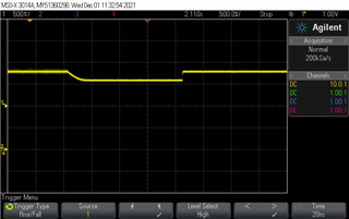

  • I have made the suggested test with the diode. Now I use 0x80 and 0x81 to sleep and wake, so the internal regulator is in use, as expected.
    AREG starts to fall on sleep, as before, but clamped by the added external diode now. So it is forced not to fall below a level, see screenshot. The register settings are lost.

  • So, after configuring the registers and running on internal regulator, I just wrote 0x01 (active mode, external reg), wait 2 seconds, then 0x81 (active mode, internal reg).
    Without the diode clamping, AREG starts falling when changing regulator to external. After setting back to internal, the registers are not retained. (see scope recording)
    With the clamping diode, AREG falls just to the clamp level, then back when returning to internal regulator. In this case, the registers are retained OK. (see scope recording)

  • I am including a snapshot of the e mail sent by our TI Engineer Carson. It seems he is able to
    retain values. AREG_SELECT=1 . It looks like internal regulator is in use. I have asked him to try to confirm
    if not external 1.8v is given on AREG pin. In addition he is to take the waveform on AREG pin when we move in and out of sleep.
    if we confirm that the system is operating on 3.3v Only then it may be a layout issue creating a reset when the regulator powers back on after wakeup from sleep
