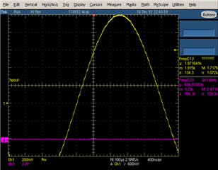

  • Try changing the RC filter with a LC filter, start with L=33uH and C=660nF and see if that's ok for their system
    You can tune that further by increasing the cap value if needed.
  • Hi Peter,
    Is there any improvement?
    Could you please let me know the captured waveform before and after applying LC filter?
    I have to check it first and I need captured waveform in condition of span (40us/div, 200mV/div) of oscilloscope.
    Pls, understand my request.
    Michael
  • With RC:
    with LC (33uH, 660nF):
    with LC (33uH, 853nF):
