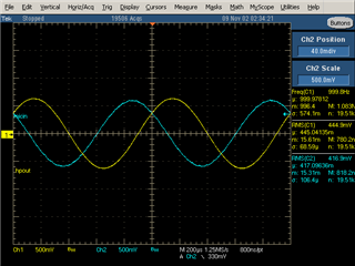

    Our customer is evaluating that audio loopback path from MIC1RP to HPOUT.
    Signal distortion is observed on the HPOUT like below waveform.
    Could you please check symptom, schematic, register setting and give your opinion to me?

  • Hi Michael,
    Try with the following settings:
    3465.register.xlsx
    based on the following clock tree.:
    regards,
    Peter

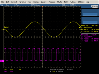

    Our customer has another issue on the No.2 audio path like below image.
    No.1 audio path is no issue.
    They set all of gain 0dB on the No.2 audio path.
    But, Output is higher than the input signal and has noise.
    Could you please check register setting and give me resolution?
    Our customer have to clear this issue and produce mass product.
    Pls help us.

    Also, we have test another audio path which is CPU (Digital, Sine Wave 1KHz Signal) -> Audio Codec (DAC -> HPOUT).
    When we check signal w/ scope at HPOUT, there is noise like jitter.
    Below is waveform.
    Do you have any good idea to solve it or your opnion?
    and which registers do I have to check and change?
    Could you please tell me what do I do?
    Michael

  • Hi Michael,
    Here is what I see on the EVM, it shows output a little higher than the input.
    Is this a problem for customer?
    Peter

  • Hi Michael,
    This is not spec violation, the headset FS output voltage is a typical value.
    It's normal to have little variation, you can always play with the gain.
    Attached is my setting.

  • Hi Peter,
    Here is our test result.
    But there is no improvement on DAC path.
    Refer to the below test result.
    BR,
    Michael

  • Hi Michael,
    This is my DAC settings for 8KHz and the response.

    Peter
  • Hi Peter,
    Thank you very much for your effort and feedback.
    We can't find stair issue at span 400us of oscilloscope.
    We need to check waveform in condition of span (Tdiv = 40us) as our customer setting.
    So we can clarify this issue.
    Could you please check and send waveform what I requested?
    Michael
    Please try on their setup with this setting as I have seen improvement.
    Regards.
  • Hi Peter,
    Could you check it again in condition 40us/div, 200mV/div of oscilloscope?
    This setup was our customer's condition.
    When I check it at 40us/div, 1V/div w/ customer, there is same as you sent waveform.
    But, When I check it at 40us/div, 200mV/div, there is no improvement.
    Pls send me the captured waveform.
