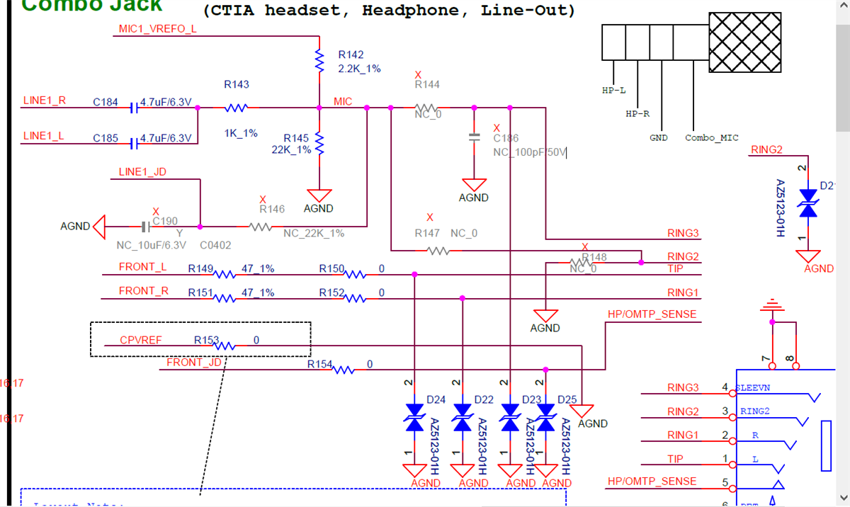

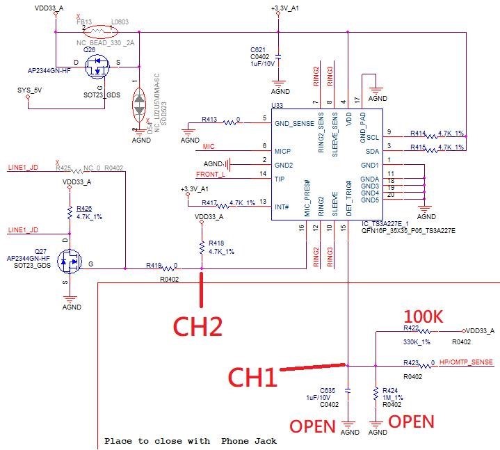

My customer have meet TS3A227E sometimes can't normal detect 4-pole TRRS(every device may happen, fail rate ~5%, maybe plug 20 times meet once),

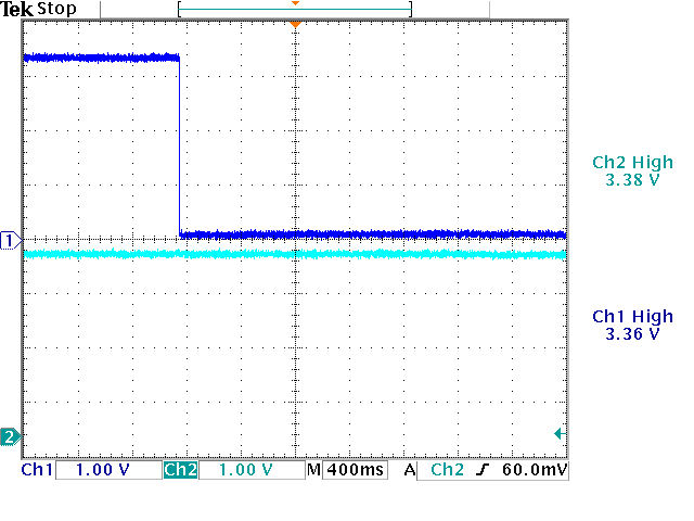

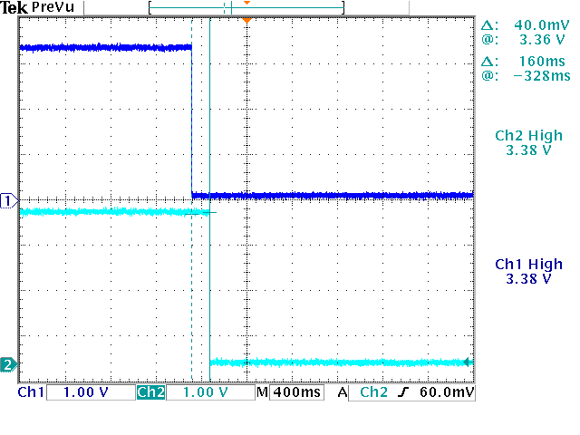

In below waveform, DET_TRIG# pull low, but MIC_PRES still high.
I have ask customer to check the impedance between the mic and GND(Sleeve/Ring2).
Except impedance, any possible to cause this issue happen?
Normal operation:
Can't detect Mic:
