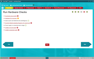

But running the PurePath console 3, updated to 3.2.0 build 302, speaker characterization, the hardware check said
1. Download unsuccessful, x
2. Hardware ID is incorrect, !
3. incorrect default sampling rate, x
4. Unable to record, x
5. Unable to playback, x

         The newest version of learning board with XMOS device should use a new APP in PPC3, as the picture shows below. I just grant you the access, you will receive e-mail from TI soon. But the newest version of PPC3 should be v3.2.1, Build 306. You'd better update to the newest version, in case other strange problem happens.
  • Hi Shadow,
       Thank you for your help. The XMOS PPC module can work. Download is successful now. But the sound card was still in DFU mode. I believe is a way to revive this learning board back to normal state. Isn't it ?
