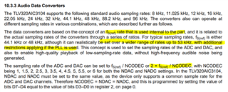

  • Hi Lidong,
    This dual rate is referred to doubling the sampling rate as described in the datasheet below:
    1. You can set that if you want higher sampling rate.
    2. See above paragraph from datasheet, enable only if you want higher rate.
    3. If you want sampling higher than 48KHz then you can enable that.
    Peter
  • So, starting from the following setting: codec fsref= 48Khz/ 4,096MHz master clock, if we enable dual rate, the codec working sampling rate (that is fsref ) will be 96KHz, and then I just need to set REG2 with NCODEC=6 in order to set both ADC and DAC to final sampling rate of my data (that is 16KHz), or we need to change something else as compared to the fsref=48Khz?
    Do you think that in this manner (fsref=96KHz) in band noise would be less audible during "silence" time?
  • Hi Lidong,
    fS(ref) is an internal rate as described below and should fall within 39KHz to 53KHz normally this is either 44.1KHz or 48KHz, when in dual-rate it's NOT fS(ref) becomes 96KHz but it's just multiplied by 2, fS(ref) is still 48KHz and the NCODEC will need to be 1 to get sampling rate of 96KHz. You use this dual rate if your actual sampling rate is above 48KHz, if 16KHz you don't need to use dual rate.
