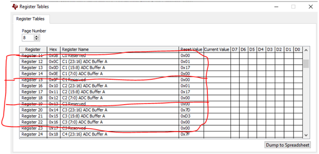

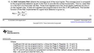

    Did you get a chance to look into my question?
    I have a question, look at the snap below
    both coefficients D1 in First order IIR and N0 in Biquad A refers to C39 but the registers are different. Should C39(Pg 9,Reg 40,41,42) be C38(Pg 9,Reg 40,41,42)  in First order IIR or Is that a typo in the document slaa557.pdf. If so, Can you please tell me which one is correct?
    For confirmation can you tell me What are the default coefficient values used for AGC low pass filter?
    Also can you please tell me which block includes AGC low pass filter in the ADC processing block PRB_R11?
    So there are two 1st order IIR filter used in the ADC processing block PRB_R11. So I want to know that which 1st order IIR filter belongs to what in the PRB_R11. See the snap below.

  • "So for the Filter 2 which uses the first order biquad transfer function not the second order biquad transfer function so do I need to divide the values by 2 and then use signed two's complement of that?"
    No, You do not need to divide by two or take the twos complement
    Yes, This should be C38. this is a typo.
    these are the reset values for AGC coefficients
    Arthur
