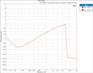

When output is 0.9W, looks like result is nonlinear, is that correct?
AMP 4.2V,dummy load 8ohm.
0.7W:
0.9W:
    Is there a schematic you can share? Are you using an EVM board?
    Also can you share some captures of the output in time domain at specific frequencies in and out of that range of frequencies?

  • Hi Ivan,
    It isn't EVM board.
    This  is a open loop test in system. I don't know how to capture the time domain.
    I attached the schematic for your reference.
    Thank you!

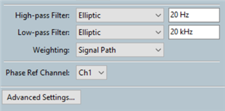

  • HI Ivan,
    I used the low-pass filter "AUX-0025" from Audio Precision, and I also used the SW filter in Audio Precision which is sitting as below,

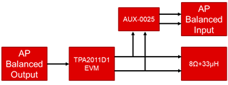

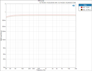

  • Hi Jean,
    I did the test on my side, please see the details below:
    • Test setup is as below:
    • Test results:
    Could you please try by manually setting AP output to EVM for higher frequencies instead of running the sweep? What is the waveform looking on the monitor?

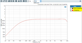

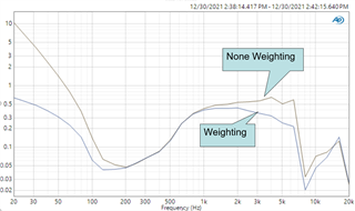

  • Hi Jean,
    I asked to manually set just to double check if the waveform was distorted or something similar. I also used stepped frequency sweep for my results above:
    Test results:
    In order to keep debugging, can you try with the other channel on the AP?
    Also can you try by setting Weighting to None? I used None and actually I don't see "Signal Path" option on my side.
    If you read THD+N for a specific frequency like you did above with scope, I assume this is below 0.5% correct? (as opposed to sweep plot)

  • Hi Jean,
    Thanks for adding more tests. I think this latest plot is better than the first:
    Initially it was like this:
    0.9W:
    It seems now it is like this
    I used another channel to test the AMP.
    The video recorded condition is same as the picture.
    I think the results are now closer to the expected from data sheet spec.
