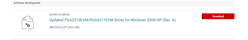

The EVM does not seem to connect correctly to the PC (using Windows 10). In the device manager the converter shows up under USB controllers as "No Printer Attached" and "USB Printing Support" but I see no way to set or access ports in the way to EVM Gui expects (e.g. 378h: LPT1).
I tried installing the additional PGA2310EVM software for Windows XP as well as trying it under different compatibility settings on the different addresses with no luck.
