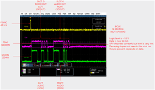

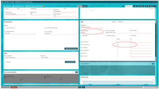

    • Hi Ivan,
      I was able to observe the TDM time slot arrangement and to measure audio levels from the EVB using the "snapshots" in the provided PPC3 configuration file.
      When using "Snapshot 2" (Audio Out / In) the AUDIO OUT level in SLOT 0 is comparable to the audio input level, however, the AUDIO IN level in SLOT 4 is attenuated by about 30 dB vs. the input level.
      When using "Snapshot 3" (V-Sense / I-Sense) the V-SENSE level in SLOT 0 is ~10 dB lower than the audio input level.
      The audio input is a -35 dBFS 1 kHz sine wave (measured at SDIN) and the audio amplitude at the loudspeaker is ~55 mV.
      Please refer to the screen shots below and advise if these are expected results.  Am I testing it correctly?
      Thanks, O.R.
      TDM time slot arrangement in "Snapshot 2" Audio In / Out:
      Audio input levels (SDIN):
      TDM bus AUDIO OUT / IN levels ("Snapshot 2" SDOUT):
      TDM bus (V-SENSE / I-SENSE levels ("Snapshot 3" SDOUT):
      Audio level at loudspeaker:

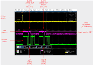

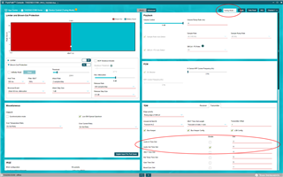

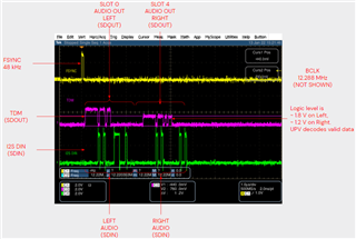

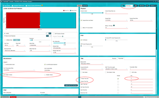

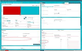

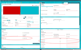

    • Hi Ivan,
      I applied your mono example file settings to one of our stereo PPC3 files and achieved a valid output on the TDM bus (Audio Out from the left and right amplifiers on different slots), except that the logic level is only 1.2 V.  (Decoded correctly by the UPV analyzer when I changed its logic level setting.)

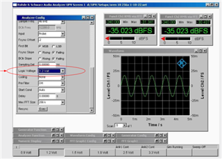

      - What needs to be changed for 1.8 V logic on the TDM bus?

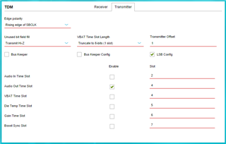

      - I noticed that the Audio Out data is only 16-bit, which was also the case with the example file.  (This is readily apparent when scope display persistence is turned on.)  Is this expected?  Can the Audio Out data be 24-bit?

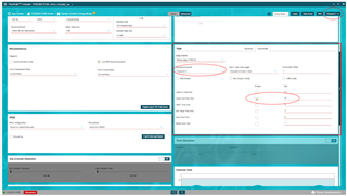

      - What do the "Bus Keeper", "Bus Keeper Config", and "LSB Config" bullets do?

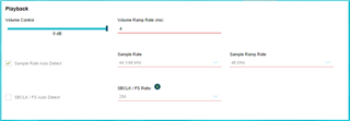

      - The Playback panel settings are grayed out.  How can the SBCLK/FS ratio be set to 64?  (I was able to change it at one time but it had no effect.)
      Please refer to the screenshots below and advise what settings need to change.
      Thanks, O.R.

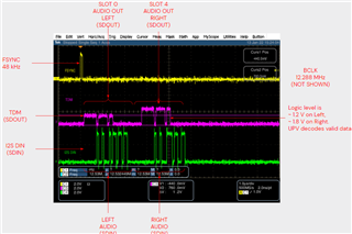

      TDM time slot arrangement in EC Debug (Audio Out LEFT in Slot 0 and Audio Out RIGHT in Slot 4):
      (Note lower logic high vs. output with example PPC file.)
      TDM SDOUT from EVB (Audio Out LEFT and Audio Out RIGHT levels comparable to input level.):

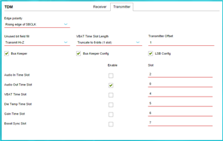

      Channel 1 LEFT Receiver Configuration:
      Channel 1 LEFT Transmitter Configuration (Audio Out Slot 0):
      Channel 2 RIGHT Receiver Configuration:
      Channel 2 RIGHT Transmitter Configuration (Audio Out Slot 4):

      • You should be able to change Playback settings by using Advanced mode on the top-center of Device Control panel.

      • I experimented with various combinations of setting "Unused bit field fill" to "Transmit 0" and "Transmit Hi-Z" and observed correct logic levels depending on which setting combination was used.  The "Bus Keeper" settings didn't seem to have any effect.  It would be best if you would send an example stereo file that illustrates best practices.  (Please send through our local TI FAE.)
      • I was able to change IVMON_LEN to 10 by sending I2C commands and observed 24-bit data but the amplitude was very low.
      • The Playback settings are grayed out in Advanced mode so I can't change them, see screen shot.
      Please refer to the screenshots below and advise.
      Thanks, O.R.
      1) Transmit Hi-Z On Both L&R, No Bus Keeper:
      2) Transmit 0 on Left; Hi-Z on Right:
      3) Transmit Hi-Z on Left; 0 on Right:
      4) Transmit Hi-Z on Both L&R, Bus Keeper Set on Left:
      5) Transmit Hi-Z on Both L&R, Bus Keeper Set on Right:
      6) Transmit Hi-Z Both, Bus Keeper on Left, IVMON_LEN = 10 for 24-bit set by I2C:
      Grayed-out Playback settings in Advanced mode:
    • Hi Oren,
      I'll share the stereo configuration files when I'm back in office on Tuesday.
      I noticed the playback settings are only accessible in ROM mode, however device should be able to work for a ratio of 64, are you having any issues with that setup? I'll double check but my understanding is that the configuration from End System Integration is enabling autodetect feature.

    • Hi Ivan,
      I received the example stereo PPC3 file, thank you.  Re: Snapshot 2...  I noticed that “Bus Keeper”, “Bus Keeper Config”, and “LSB Config” are checked for Channel 1 while only “LSB Config” is checked for Channel 2.  What is the rationale for this setting combination?
      We are still sorting things out on our hardware but SBCLK/FS Auto Detect seems to be working correctly per this waveform capture:
      Thanks, O.R.
    • Hi Oren,
      Good to know you're getting correct waveforms now.
      Only 1 device in the bus should be set as bus keeper, otherwise there may be conflict on holding the bus. For the same device, bus keeper feature should be always active. LSB config is used for only half of the cycle to prevent conflict between LSB and MSB from adjacent slots.
      -Ivan Salazar
      Applications Engineer
    • Hi Ivan,
      Please confirm...  "Bus Keeper" and "Bus Keeper Config" are both checked on one device in a dual device system.  "LSB Config" is checked on both devices.  We aren't using adjacent slots so, if I understand correctly, "LSB Config" shouldn't make a difference in our setup.  Here are screen shots to illustrate:
      Channel 1:
      Channel 2:
      Thanks, O.R.
    • Hi Ivan,
      Another thing...  On the "Receiver" tab in "Slot Select Config", what is the difference between selecting, for example, "Mono with slot as I2C address offset" vs. just selecting "Mono left channel"?
      Thanks, O.R.
    • Hi Oren,
      Regarding your first post, that is correct. I wouldn't expect any considerable difference if enabling or not LSB Config.
      There are basically two types of receiver configuration:
      • Selecting "Mono with slot as I2C address" means the device will be automatically selecting I2S slot based on the ADDR_SPICLK pin configuration, eg. address 0x4c = slot 0, 0x4d = slot 1, etc.
      • In case of Mono Left, Mono Right or Stereo Downmix, slots would depend on your specific slot configuration, then you can select only one of a mix of both.
      -Ivan Salazar
