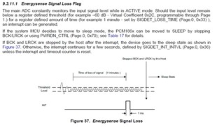

Please help to confirm whether the function of inputting analog signal to wake up the system in standby state for PCM1863.
This feature does not wake up the IC once clocks are applied. the IC needs to be woken up by the MCU.
