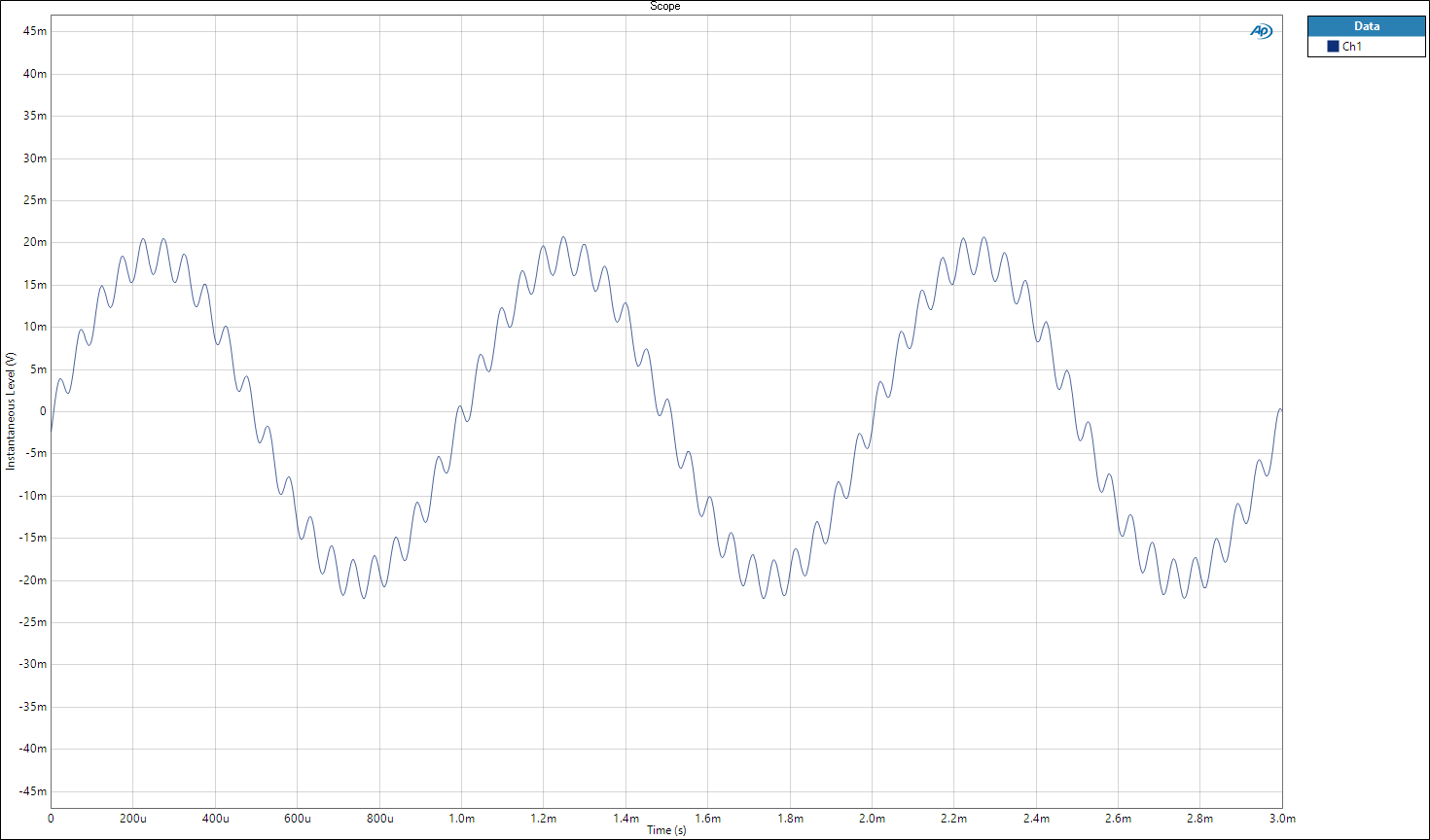

Hi team,
In no input, we found around 20kHz noise on our application.
and we input sin 1kHz wave at -60dBFS volume.
The noise appear on the waveform.
What could be the cause of such noise?

Hi Kenta
With very high possibility, this noise is coming from the power source. Let them to check the PVDD voltage, find whether there's a 20KHz noise.
Also maybe their output LC filter's resonance frequency is happened to be 20KHz, but it is rarely seen. Let them also check it.
