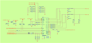

Hi,team
我能够设置 音量和mute,但是喇叭没有声音输出,输入的i2s波形能够量到,输出的模拟波形没有量到,附件为我的驱动代码,和电路图. 请帮忙分析一下,谢谢.
I can set the volume and mute, but the speaker has no sound output. The input I2S waveform can be measured, and the output analog waveform can not be measured. The accessories are my driver code and circuit diagram Please help analyze it, thank you

  • Hi Zeng,
              1. Suggest you to read register 0x68 and 0x70~73 in book 0/page 0 to confirm whether there is a fault happening during this time.
              2. Pls follow the power on sequence in TAS5805M datasheet.
    Leon

    2. I check the power sequence, and the power on sequence is consistent with the specification
  • Hi Zeng,
            1. Register 0x70 reports 0x02, which represents that there is a OC fault. Suggest you to write 0x80 to reg 0x78 to clear all the fault. Then read back register 0x68 and 0x70~73 in book 0/page 0 again to check whether there is still a fault.
            2. Pls provide the wave of power on sequence including BCLK/LRCLK/SDA/DVDD/PVDD/PDN
    Leon
  • 1. while I play the music , the  Register 0x70 reports 0x02 always , even i write 0x80 to reg 0x78
    2.the pwer sequece i will check
    3.I have only one speaker in MONO mode, what i have to be changed in .h file, thank you
  • Hi Wang,
           From your description, I think the reason why the OC fault happens is that you use BTL configuration for PBTL output, so the amp thinks output is shorted together and report OC fault.
           Suggest you to use PPC3 to dump a PBTL version script then have a try again.
    Leon
