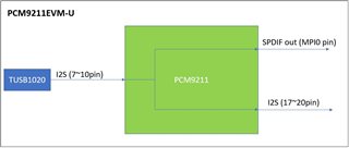

    Customer require condition is below block.
    PCM9211 :
    I2S input : MPIO_C0~3(from TUSB1020)
    I2S output : 17~20pin (bypass from TUSB1020)
    SPDIF out : MPI0 (I2S to SPDIF)
    Thank you.

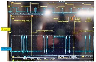

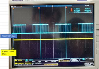

    PC -> TUSB1020 -> PCM9211 optical out : this path is ok. we checked operation.
    But I2S DOUT of PCM9211 is not operated. (PC -> TUSB1020 -> PCM9211 I2S)
    Clock of PCM9211 I2S main output is ok. (SCK, BCK, LRCK). please refer waveform below.
    DOUT of PCM9211 is only high. please refer waveform below.
    Could you review this problem?
    Thank you.

  • Hello Downy I looked at the scripts  in details and found few things that I could not follow why they did it , of course I amnot saying that is the reason for what they see.
    #System RST Control
    #w 80 40 00
    w 80 40 33
    w 80 40 C0
    w 80 42 19
     w 80 42 11
    w 80 42 10
    w 80 46 d7
    w 80 47 d7
    w 80 34 80       ( 1000 0000)  b7=1 power down for RXIN0 coaxamp ( Please refer to note in DS)
    w 80 35  e0
    w 80 36  bc      (1011  1100   b4=1 mutes MPO1, b4= 0 is the default)
    w 80 60 44
    w 80 6b 44
    #w 80 6b 14
    The first thing is they  write in the same  register consecutively several times  (for example they right on registry 42 several times, only the last code will be effective , if they had other lines in between I would guess , may be they were setting it up for other registers first and then right the final code )
    In register 36, bit 4 mutes MPO1, is it what they want to do?
    In register 34 they write 80  , bit7 =1 but the notes mentions RX0DIS or RX1DIS must be set to 0, even when an S/PDIF, TTL, or OPTICAL input is provided into RXIN0 or RXIN1, without use of the built-in COAX amplifier.
    Having said that, I couldn't figure out if  any of these could possibly put the output at  high all the time. I hope they can use this to make some modification to see if any of them makes a difference.
