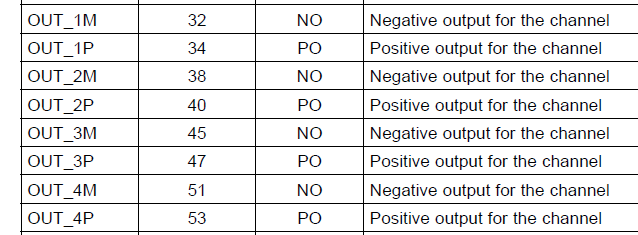

I'm using below audio amplifier in my design and I'm new to audio section.
TAS6424LQDKQRQ1
Do I need to route audio output (4 channels) with 100E differential impedance? or any other guidelines?
These lines will be connected to a connector.
thanks

  • Hi Gregg,
    Thanks for the quick response. I'm following the typical application circuit for schematic implementation.
    And I'm talking about the differential audio outputs below. These are differential right? so, I'm saying generally in digital interfaces we route differential interfaces like PCIe with 90E/100E track impedance. For these audio outputs do we need to follow 100E differential track impedance. Also the current on these lines will be 4.5A (over current limit). That makes us to use large trace width for these output lines.
    Mallesh V
  • Mallesh,
    The trace length from the output pins to the inductors should be as short as possible as indicated in Section 12 of the datasheet.  The switching frequency is low, so you do not need to impedance match these traces.  This is a power amplifier, so you definitely need to increase the trace width and copper thickness to accommodate the higher currents.  After the inductor you only have audio frequencies and impedance matching is not needed at all.
    Gregg Scott
  • Thanks Gregg
    Got the required answer
