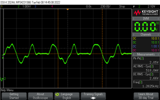

Recently we have replaced our old audio chip with TAS2553. But I couldn't get the desired audio output in the speaker as an earlier chip. I am getting very very low audio in the speaker out.
I have read and verified all the configuration registers.
1 ) I2S digital Input,
2)  I2S WCLK configured as 22.05 khz
3) I have measured the frequency as BCLK -> 705 khz I2S_MCLK -> 5.6 MHZ
4) I am trying to play a 22ksps/48K sps audio file. I have switched the I2S frequency to 48K when playing the 48Ksps file.
I have configured as below,

  • My audio output for old IC and new TAS 2553 IC,

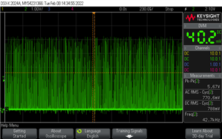

    The old IC is a different manufacturer(Cirrus logic). They were using FLL method. We have configured the FLL frequency as 75.898 Mhz and class AB amplifier. Now I calculated and configured the J.D and P values to get the 75.898 MHZ according to the TI datasheet. My output audio frequency is still very high around 42.7 Khz.
    Param.
  • I couldn't see any change in the output frequency in the out+ & out- waveforms. I changed clock sources as MCLK,BCLK, Internal OSC) and modified J,D,P values, but no variation in the output frequency level. Disappointed

    I'm trying a similar set of clocks on my side, I see distortion issues at higher frequencies most likely due to incorrect PLL configuration.
    You should calculate the PLL settings based on data sheet description: https://www.ti.com/lit/ds/symlink/tas2553.pdf#page=16&zoom=100,0,316
    Perhaps it's better to use MCLK as PLL source instead of BCLK, so that PLL_D can be used without compromising the conditions at the bottom of page 16 from data sheet.
