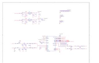

We are a 26MHz MCLK with a sampling rate of 8K and 16 bits. BCLK is output. But our sound card has no sound. We suspect a register configuration problem.
Please give us some suggestions, if it is convenient.
If we don't have a clear description, please reply to us.

    So your ADC path (MIC1P/M) is working, but the DAC path to LINE output is noisy - is my understanding correct?
    Your settings are not following what I have provided especially the PLL and its divider.
    Please use the settings I have provided, if you decide to change then please use the PLL clock calculator from the product folder so the PLL criteria are met.

    "I tried to configure the register as provided by experts. At present, I can still hear a little sound at the SPK end, but there is a lot of noise, which is similar to the feeling of great bottom noise plus echo.
    In addition, I see that the circuit diagram expert posted on his post is also output to left-lop, while the circuit design on my side is only connected with right lop and right LOM. Please see the schematic diagram I posted back to the expert to see if there are better suggestions."
    Thank you

  • my bclk is about 512kHz, and wclk is about 16kHz,as shown in the picture
  • Is the path we are choosing unfiltered? I'm making a lot of noise. Should I configure the page1 register for filtering? Can you give me the recommended configuration

  • hi Peter
    I have solved the problem of noise,I set the reg10 that "Audio Serial Data Word Offset Control" is 1, the noise is gone;
    At present, there is another problem that the volume of my DAC is too low. although I set reg44 to 0x0 and reg93 to 0x99, the volume is not high enough. Is there any way to raise the volume
