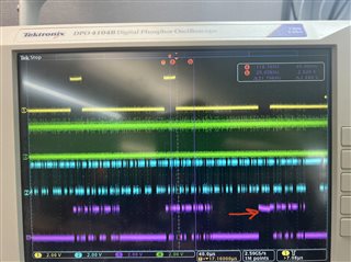

Hello!  I need some help on an issue where I have two ADC5140 ADCs configured in daisy chain mode (as per figure 9 in the app note : Multiple TLV320ADCx140 Devices With Shared TDM and I 2C Bus).  I am using TDM mode, 24 bits, 8 channels (4 from the first ADC, 4 from the second).  It is working for the most part, but randomly I am getting all 0's or all 1's from the first channel of the last ADC on the chain.  I have attached a scope shot that illustrates the issue.  My initialization code is as follows:

Can anyone give me any hints on why I would be getting intermittent samples that are sticking to all 0's or 1's?  And only the first channel of the second ADC?
Thank you in advance everyone!
  • Quick update.  It seems as though the "error" is related to the input signals.  I am driving the inputs with two outputs of a function generator, offset by 180 degrees.  If the inputs are larger than about 20mVpp, then the issue arises.  However, I can see from the datasheet that the inputs (with AVDD =  IOVDD = 3.3V) can handle up to 2Vpp - so I am still confused.  Hopefully this helps!

  • Hi Bucky,
    Just checking if your issue is resolved now or if you are still waiting for an additional response? My interpretation of the original problem is that when neither ADC is transmitting on a slot, it will go hi-z and could float either high or low if there is nothing holding the bus.
    Brian
  • Hi Brian,
    I actually got things working by making the first ADC run off of an external crystal and then daisy chaining it through the second ADC.  I haven't posted here because I still wanted to see what the solution to my original setup was - I was still waiting on Sanjay.
    The problem was that everything would work perfectly 95% of the time, but some random frames would have the first channel as what appears to be Hi-Z.  In the original scope shot you can see that the first two frames are fine, but then the third frame's first sample is wonky.
    Thanks!

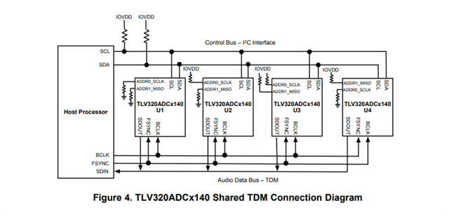

  • Hi Bucky,
    I apologize for the delayed response.
    Have you considered trying shared TDM? You have just 2 devices so the SDouts of the chips can be tied together without worrying about capacitive loading.
    In Daisy chaining where a loop through of the DATA happens and timing delays are a possibility. It might be a thought to try Shared TDM to see if you solve the issue
