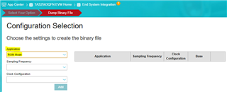

    Another question, can the customer load the bin file at PPC3 ? Or PPC3 only can load the project file?
    Do we have a reference PPC3 file for TAS2563QFN EVM that can provide to our customer?
    Len
  • Hi Len,
    bin file is mean to be used only by the driver on the end system, it cannot be load into PPC3.
    PPC3 can only load project file or cfg script which you can load into the I2C monitor.
    The default PPC3 settings should be able to initialize the device, although the speaker has to be characterized so that speaker protection algorithm is running properly. One way to test the basic functionality of TAS2563 would be to use the ROM mode:
    • ROM mode can be load by going to Device Control panel, then select ROM Mode on the list from the top-right corner, then click on Apply
    • Or you can generate configuration files by End System Integration, then in the Application list select ROM Mode
    -Ivan Salazar
