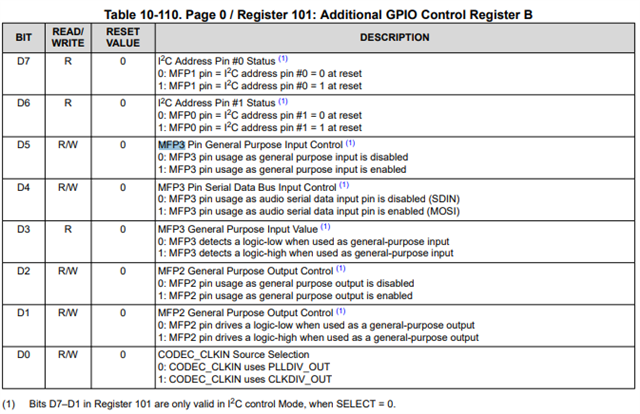

  • Hi Kevin,
    It seems you are writing 0x10 to Register 101 (0x65) which is making the MFP3 Pin act as the SPI MOSI function, not the SDIN function. Try 0x00.

    Thanks for your response. After trying 0x00, the result is the same as before. I do not see the waveform at DOUT pin (DOUT --> PCM DIN). Is it possible the I2S function still works becaue I do not configure it (all setting for I2S is default in codec).

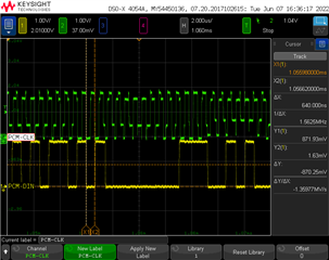

  • Yes, no problem.
    I measured the clk at the "GPIO2" pin and the data at the "MFP3" pin.
  • Hi Kevin, thank you for your patience,
    Yes Register 9 needs to be configured. Even though there are different pins for the I2S and PCM data buses, they are muxed into the same audio interface, so the configuration needs to be done.
    Thank you for sharing the plot. The clock has some odd distortions in it that may be affecting the performance. You can see the high and low levels are changing, and there are spikes on the edges that last for some time. I would try to clean that signal.

  • Hi, Jeff
    I have connected the PCM_CLK pin to the BCLK pin, the PCM_SYNC pin to the WCLK pin, and the PCM_DOUT to the DIN pin. The scope result is I measured at the BCLK, WCLK, and DIN pins, but I do not detect the waveform at the DOUT pin. The WAV source file is 16K with PCM-16bit format.
