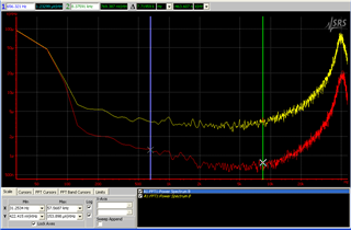

  • Thanks for getting back to me Ivan.
    The figure below shows the noise measured without any applied input signal. The yellow trace is with the class-D driver at 24dB gain, the red trace has it set to 6dB gain, attenuator is 0dB in both cases. I should note that this is taken after an LC differential output filter (10uH, 1uF). I suppose in the region up to ~10kHz then it would largely agree with the 87dB SNR spec for 6dB gain as shown in the datasheet. That said, at 6dB class-D driver gain the audible white noise was not really an issue - mainly at the higher couple of gain settings. Perhaps this is normal after all, I was quietly hoping there might be some tips for improving it though.
    6dB (red), 24dB (yellow) class-D gain
    Noise before and after audio is interesting. Before any audio has been played, changing the DVol setting doesn't seem to affect the white noise volume. After sound is played using the "beep" generator the noise volume seems to have increased slightly and now muting the DVol setting does lead to a slight reduction in noise volume. I'd like to better understand why this might happen.
  • Hi James,
    Thanks for sharing your test results, like you mentioned this looks like the expected results.
    Regarding the noise before and after playback, this is basically due to the DAC, once it's feed with some data it will keep a bit higher noise floor at the output.
    This is expected as well.
