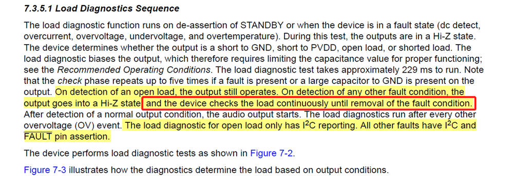

  • Hi  Gregg
          thanks for your reply, It's very helpful to me;
          You say "There is no real time diagnostics on this device.",  But the red underlined part at the bottom of the datesheet doesn't mean real time diagnostics on this device?
  • Rain,
    You cannot read half the sentence.  You must read the whole sentence.
    "On detection of any other fault condition, the output goes into a Hi-Z state and the device check the load continuously until the removal of the fault condition."
    This means after a fault is detected it continuously runs load diagnostics.  It will be in the Hi-Z state at this time.
    Gregg Scott
