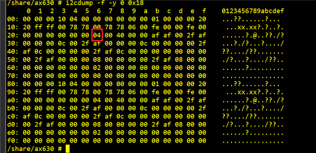

I am using TLV320AIC3104IRH, we are using HPLOUT HPLCOM HPROUT HPRCOM as output and I checked reg value in the below picture, all is OK.

    By looking at this picture:
    this is the default reg value, and now it is in working order. As you can see, when changed the reg38 default value as 0x04, default is 0x00. Don't know why.
    For your assistance.
    Thank you.
    Archie A.

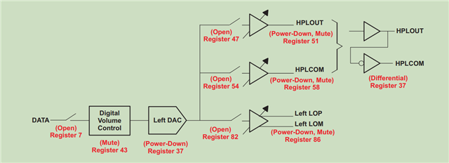

    These registers above are showing none of the audio paths are powered or enabled.
    No input/output is connected to the ADC or DAC path.
    Can you recheck and pull the correct settings so we can review?
    Basically you need to ensure the path is set correctly based on the register settings.
    I have attached here a block diagram of this device with its register address that you can refer to for your configuration.
