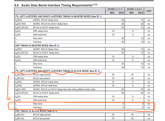

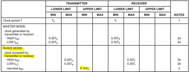

Hi team,
As the attached chart shows, when in the slave mode, it doesn't have any value on tr and tf parameter ,at reveiver side.
Why the tr and tf values ( < 8ns )that written in the datasheet?
