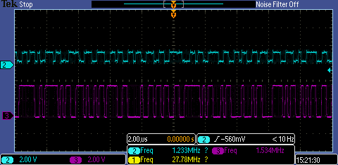

The DMIC I'm using is 1.8V output. How can I use this input to PCMD3180 and get 3.3V level of TDM signal output to avoid a level shifter? Will this configuration work: IOVDD = 3.3V, AVDD=1.8V?
The I2C control is still running under 3.3V.

Hi Yong,
I tried this on an EVM and it does work. See plot below: PDM in Blue, TDM in Purple
