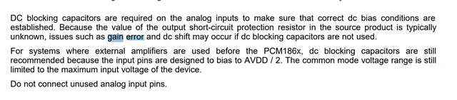

  • Mochi,
    Thanks for the explanation. It sounds like the customer is using DC coupling, is this true? DC coupling is not recommended. See this detail from the datasheet. We can review the customer schematic if further investigation is needed.
    Brian
  • Hi Brian,
    Thank you for prompt reply.
    Yes, that is DC coupling. The reason is that ADC PCB and Frontend pre amp PCB are separated.
    DC blocking capacitor is in Frontend PCB and ADC PCB input pin is directly connect to a connector.
    To avoid ESD event to High impedance input pin, they put 100kohm resistor.
    We will recommend to move DC blocking cap to ADC input PCB side to eliminate DC coupling resistor.
