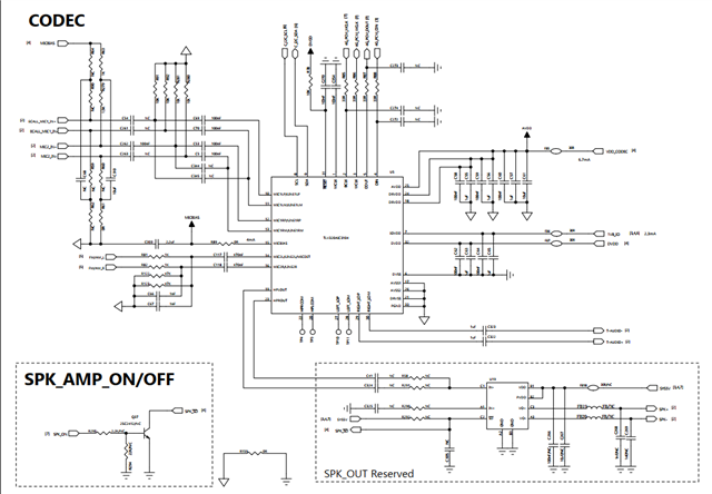

     tks for your comments. we just follow your method and fixed. But we found another issue from the MIC path.
    as below B/D, we connect the FM signal with MIC pin14,16. you know , the FM sometime will have noise, so we change the PGA Capture volume as 0, it can eliminate the noise ,but sometime we found that there is no sound come into the MIC part. it may be cause by the PGA setting .
    would you share some suggestion to decrease the noise from the FM ? tks ~

     the customer just have some modification on the MCLK part ,which connect to GND. and i attached the latest register list and waveform as below, can you help to support the echo issue? tks ~
    9-7 AIC3104 config list.xlsx
  • Are you saying they connect MCLK to GND? MCLK needs to be provided to codec.
    Please check your registers, I suggest just test with 1 output path right now either HP or LINE and use the same DAC path.

  • Yes, as shown below:
    1. MCLK is connected to GND through 100nF.
    As I can see, customers think they can set R102 to 0xA2, so CLKDIV_IN and PLLCLK_IN use BCLK and don't need MCLK, do you mean this is not recommended?
    And also the customer set the R102 initial value is 0x02 when is calling, if playing the radio will set the PCM hardware interface, and set R102 to 0xa2,do you think it is okay with that if base on the customer circuit
  • As long as they set the register to use BCLK that's fine.
    They can start with 0xA2.

  • hi  pdjuandi :
     sorry for the inconvenience, i am try to make you clearly and for me side to understand the logic of the register setting.
    Play the FM radio, it will take 5-6s to have a sound outpu
    regarding this issue, the FM comes from pin14 16 (MIC2L/R)and output from pin 29 30(RIGHT_LOM/P).
    So i think we should use DAC_L1 and R1 as Figure 10-16 mentioned: If instead the DAC analog output must be routed to multiple output drivers simultaneously (such as to LEFT_LOP/M and RIGHT_LOP/M) or must be mixed with other analog signals, then the DAC outputs should be switched through the DAC_L1/R1 path.
    5618.AIC3104 config list.xlsx
    But base on the previous config list you provide. you set the R41 to 0X51, which means the Left_DAC=DAC_L3, Right_DAC=DAC_R3. but i think the LEFT_LOP/M  and RIGHT_LOP/M are separate channel to output  different audio signal. Can you help to share your suggestion? tks
  • Is the FM input a stereo SE input or mono differential input? You are connecting the input to stereo input (MIC2L/R) but wanted the output only on RIGHT_LINE differential output.
    DAC_L3/DAC_R3 are what they have set from their initial settings, they can change to DAC_L1/R1 if that's what they want.
    Again I suggest they used the block diagram and map out their path as I think there's some confusion with their path.
