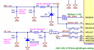

Hello, I am wondering if anyone has been able to get the headset detection to successfully work on the TLV320AIC3104?
The only luck we've had is when we insert an incorrect pinout mic/speaker. The mismatch somehow helps the CODEC discover something is inserted.
We have changed denounce settings and I assume registers are set correctly to enable headset detection, because we do get a response, but only when incorrect connect is made.
Below is our current Schematic.
Headset connector is as follows: Mic_+ve (Microphone) , LS_+ve (Speaker Left and Right, Mono) , GND (Ground)
Thanks for any help!

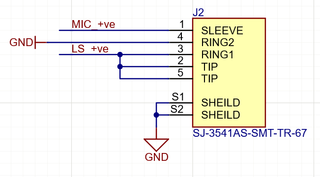

  • Below is the Schematic of the Headset Jack itself. With the connection we are making being CTIA.
    OK thanks. Just for completeness, here is how the CTIA/OMTP connection looks like and your SJ-3541AS jack.
    Make sure you are using the correct plug.
  • Yes this is the correct pinout.

    In your testing, can you check the INT Flag (Page 0 Reg. 97 D2) if that's working as expected.
    This detection should be straight from the registers if levels and driver configuration are correct, section 10.3.11 of the datasheet.

  • Can you show me your connection on the AIC3104EVM? Which connector and component you modified/replaced and the signal routing?
  • Using the same connector used in the product (J2 shown below).
    We have connected:
    MIC_+ve  >>>>to>>>> J7-Pin1 and J7-Pin 2
       LS_+ve >>>>to>>>> J12-Pin1 and J13-Pin1
            GND >>>>to>>>> J12-Pin3
    Is headset detection is supported on the EVM?
  • For the correct register 13 case (111x xxxx) you connect J2-1(MIC) to GND same as J2-4 and which pin is this Speaker Lines to Ground?

  • We discovered a change in the schematic that needed to be made, to match the suggested circuit on the datasheet. Our resistor R14 was in the wrong area. Our TI FAE found that one.
    After making this change, playing with debounce, and the order of registers. We are in a much more stable start with headset detection.
    Thanks for your help.
