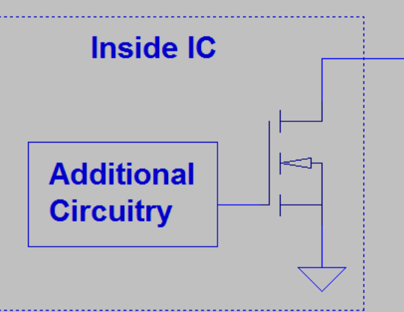

       We can consider enable Open Drain mode to support this kind of using. The Open Drain mode, our GPIO port will only gives out low level and Hi-Z state, won't gives out high level. So two Amp's class-H port can connect together and won't affect each other. The final class-H output will be the longest low level of this two Amp, to create the highest PVDD voltage for both of the Amp. Use under this way, remember to give additional pull up resistor to DVDD for the Class-H GPIO port.

       The example you raised, is the normal mode of our GPIO port. What I said is to enable "Open Drain" mode.
       Seems you are not familiar with the "Open Drain" circuit. I try to explain it here, maybe you can also google it for more information. With open drain, there's no pull up inside of our IC, there's only a MOS act as a switch. So there's only two state our GPIO can gives out under this mode, one is pulled to GND, so it's zero. Another is MOS turn off, the output is Hi-Z state, not high voltage level. For our class-H working, it's still PWM working for this MOS, but of course it can't gives out any high level voltage, it's only keep changing from GND to Hi-Z state.
       You can imagine two device's all set into this "Open Drain" mode, and connect the output port together. Is there any conflict would happen? Maybe not, with only GND or Hi-Z state, two device won't affect each other. Then you can add additional pull up resistor for this connection. Only two IC both give Hi-Z state, the final output will be high level DVDD, any of the device gives out Zero, will make the final output become Zero. The final output will be a new PWM, generate by two device together.

       I'm afraid enable Open Drain will make the Resistor network different from normal using, especially when you add additional pull up resistor, this value will also affect the final results.
       To calculate the Resistor value is not difficult, our Class-H GPIO output logic is simple. After you set the Min/Max voltage value into the PPC3, when the amp need Min voltage, it will output 100% duty cycle. And when amp needs Max voltage, duty cycle comes to 0%. When in the middle, the duty cycle will change with equal proportions. Using this logic, and work with Buck/Boost device's datasheet, should be able to calculate the resistor network that suit your need.
