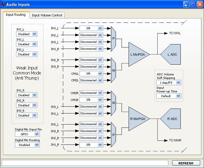

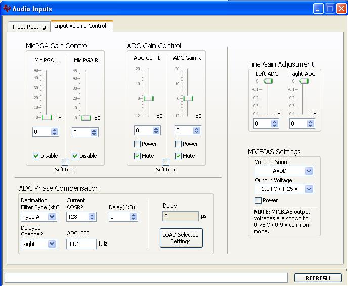

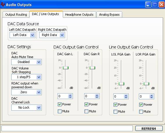

My input signal is 1Vp-p and 2hz (connected to IN1) and the AIC configured
to support the following inner chain IN1 -> ADC -> miniDSP_A ->miniDSP_D ->DAC -> LINE OUT.
In Line Out I'm expecting to get the same signal as was in the input, however the output is constant 0.9V DC
(Is it "common mode voltage"?), i.e. the signals do not pass to the outputs.
I was trying to configure the AIC with the AIC3254 CS tool and the by the PurePath studio.
In the AIC3254 CS software in the upper area we see:
   AIC3254 CS was recognised by my EVM-Board.
   FIRMWARE NAME: USB-miniEVM
   VERTION; 2.03
   USB INTERFACE: I2C FAST
   I2C ADRESS: 0x30
The configuration in the software is as follows:

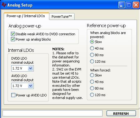

ANALOG SETTING:
           ANALOG SETUP- see Figure 1.

                   INPUT VOLUME CONTROL - see Figure 2b.

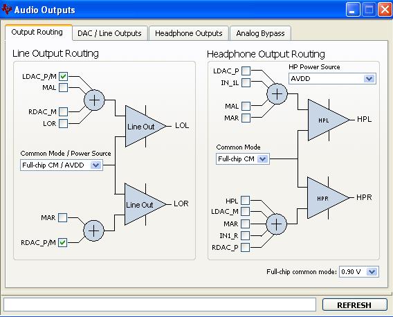

                   OUTPUTS ROUTING - see Figute3a.
                   DAC/Line Outputs - see Figure 3b.

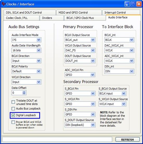

With PurePath Studio (see Figure 4):
Registers map is attached - please see ProcessFlow1
Please advise how to proceed with the current project.

    Shlomi,
    The 0.9V common mode is normal and expected.
    Please run the attached script in AIC3254 CS using the command line interface. Once executed, route the DACs to the lineouts and power and unmute the lineout amplifiers. Then, enable digital loopback, which basically routes the ADC data to the DAC input. It should now be working.
    In PurePath, please use the 8x4x framework for sample rates 48ksps and below. If you want to use the 4x2x interpolation/decimation filters, you need to modify the SystemSettingsCode property of the framework for an AOSR = 64.
