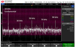

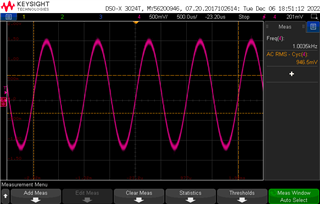

we are using the TAS5805M to output sine waves at frequencies up to 20 kHz.
At 1 kHz the Amplifiers output looks very smooth without much distortion.

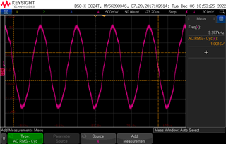

Distortions start to appear from around 3 kHz. This is the output signal at 10 kHz:
If I run the FFT, I see lots of harmonics.

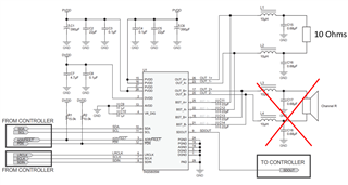

Is this an expected behavior? I am using a 10 Ohms resistor on the output. The filter has a 10 uH inductor and 2x330nF = 660 nF capacitor.
I2S sends the sine values at 48 kHz sample rate. Amplifier is supplied by 12 V.
My I2C init sequence is very simple. I do not use any signal processing.
Switching frequency is set to 768 kHz.

    1.check your signal source is stable, check the FFT with no signal input
    2. Do you have AP, it's recommended that you can use AP to measure the THD+N again, I'm not sure if it caused by your oscilloscope setting.  I have test at TAS5805 EVM, input 10kHz, load 10ohm, PVDD=12V, and the THD+N is less than 0.01%

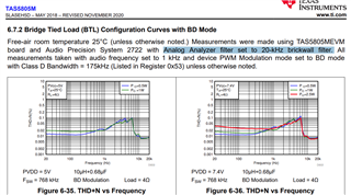

  • Thank you for your advices. I tried your default configuration file. Unfortunately, it did not help.
    I have found an important information in the datasheet of the TAS5805M:
    The THD+N measurements were all taken using a 20 kHz brickwall filter.
    We plan on using the TAS5805M for a different application, that is not audio related. Harmonics, Inharmonics and noise outside the audio bandwidth of 20 kHz cannot be neglected in our project.
    Have you tested the TAS5805M without the brickwall filter and it showed THD+N of less than 0.01%?

  • Hi Johannes
    We are concerned about audio application so we only have the THD+N result with 20kHz filter. As your screenshot shows, the THD+N start drop from about 6.5kHz, it caused by 20kHz filter the harmonics. If you don't add 20kHz filter, the THD+N will increase and don't drop from 6.5kHz.
