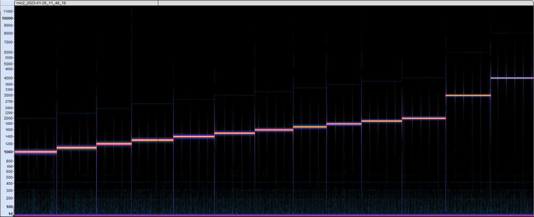

Hello there,
I am experiencing a peculiar issue with a TLV320AIC3254 audio codec that is interfacing with a Raspberry Pi CM4 via I2C and I2S on a carrier board of our own design.  We are recording audio from two microphones connected differentially to IN1_L/R and IN2_L/R respectively.  We have tested this unit extensively, and audio recording works reliably and well.  However, our end user complained about an audible clicking sound that occurs roughly every 1.3 seconds throughout any recording.  They did a test recording using a microphone, and a frequency generator outputting a sine wave through a speaker that swept through a range of frequencies.  To replicate this problem, we performed a similar test with an arbitrary waveform generator outputting a 100mV-amplitude sine wave directly into the codec's secondary input as a line-in signal.  During this test, I started at 1KHz, and stepped up the frequency at 100Hz intervals until I reached 2KHz; then stepped it to 3KHz and finally 4KHz.  As can be seen in the attached spectrogram, we are getting consistent clicks approximately every 1.3 seconds regardless of what frequency is used.
Oddly, in further tests, the timing of the clicks appears to be affected by the latency or block size, but only at the 44.1kHz sample rate. Normally we are running at a 48kHz sample rate, and adjusting latency or block size doesn't seem to change the timing.
Any thoughts of how to mitigate this issue would be greatly appreciated.
Thanks!

  • Hi Jeff,
    Thanks for the fast response.  I reuploaded the spectrogram image on my original post, so it should bring up the larger preview when clicked.

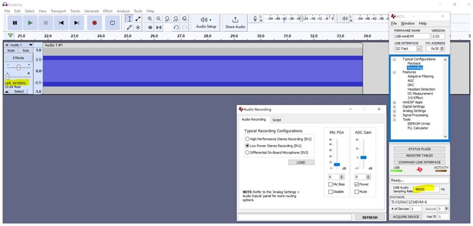

  • Hi Caleb,
    A few questions. I ran your script on an EVM and noticed that the inputs had not been configured. Obviously you're getting output somehow, but is your team taking any extra steps to configure the device? I also saw your PLL settings were different than defaults, so can you tell me what clock frequencies you're using (LRCLK,BCLK,MCLK,etc.)
    Below is a sample script that gets recording (ADCs) up and running without any issues. You may have to change your clocks if possible to get it to run correctly, but it should give you some insight at the least.

  • Hi Caleb,
    The evaluation module doesn't have a oscillator on board. I was running it in slave mode, but it sounds like you're running the device in master mode and using the PLL to generate the other clocks. Would still like to know from your developer what the intended clock tree is supposed to look like. I'm also looping in our software team to comment on the driver question and to see if he has any comments.

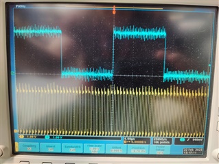

  • Hi Guy
    What I want to know is what the sample rate and bitclk is during 44.1kHz recording? Have the system-internal resampling worked during 44.1kHz recording?  I wonder what the latency or block size you have tried during 44.1kHz recording?
    Can you try one test? Write all the recorded data in the RAM first, after the recording, then write into file and check whether the clicks are still on? This issue seemed the write-file issue. I want to check how large buffer will be written into the file once.
    You can try another way that loopback the recorded data to the output directly, and listen and check whether the clicks are on instead of store into the file.
    We did change the recording mode to 44.1kHz in a prior test, and we used a block size of 44100/4 = 11025 to act as our latency.  Sample rate was 44100, but using this setting caused us a lot of problems.  BCLK frequency is set by the driver; if our codec is in Master mode according to the diagram below and our schematic, then BCLK should be 1.536 MHz with a 48KHz WCLK.  Dividing BCLK/WCLK is 32, and multiplying 44.1K by 32 yields 1.4112MHz for the BCLK at 44.1kHz.  However, I have no idea if this is actually right.
    Currently our device is set up to write all recorded data to RAM until the time limit, at which point it writes everything to a file.
    On our existing setup, we have the codec outputting the audio through headphones.  Barring the noise from the headphone jack, the periodic clicks can still be heard this way.  It's just easier to hear and visualize them by relying on the recorded file.
    The configuration below looks exactly like how our codec is configured, only we are using a 12MHz crystal oscillator in lieu of a 24MHz.
  • Can you use the scope to measure the bck and WS clk during 44.1kHz recording?
    Kindly post the waveform, I will check them. Thanks.

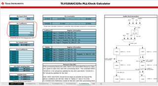

    To get the 44.1KHz sampling to work with 12MHz MCLK, please configure the PLL and divider with the value shown below:
    From the script shown above which I have added my comments below, it looks like you are setting it as slave mode and the divider is not correct giving 23.4KHz sampling and input ADC path is not configured correctly.

    Please try with the above PLL settings, configure your input path and provide the latest register dump.
    Regards.
  • Our developer has informed me that switching our entire system over to 44.1kHz will greatly complicate this troubleshooting process.  Besides the clicking issue I've described in my original post, we aren't having any problems with 48kHz, and I am afraid that this conversation is taking a very costly turn.  Therefore, please regard 48kHz recording as a requirement going forward.
    What should our PLL settings look like for 48kHz recording?

  • I tested on the EVM with 48KHz sampling then record with 44.1KHz using tone from audio precision that is swept from 1Khz to 2Khz in 100Hz step and I don't hear any click when the tone changes. See attached files.
    The above slave mode settings look okay.
    Regards.
  • Our configuration is much different from your evaluation kit.  According to the EVK schematic, MCLK is not being driven by a 12MHz crystal oscillator at all.  We're using this codec in an embedded application where MCLK is sourced by a 12MHz oscillator, because the only four I2S lines the Raspberry Pi CM4 provides are BCLK, WCLK, DIN, and DOUT.  Currently we are running this in slave mode, as we've verified that the BCLK and WCLK signals are coming from the Pi, not the codecs.  Is it technically correct to run the codec in slave mode with this configuration?
  • Hi Caleb,
    To address the K value, K is just the floating point of J.D i.e. J is the integer and D is the fractional part.
    I believe Peter tested this in slave mode according to your settings but we'll double check specifically with a 12MHz MCLK. There have been a couple changes with the PLL values that we started with and what Peter recently recommend. Can you share your developers most recent configuration script?
    Jeff McPherson
  • Hi Jeff,
    Thanks for the clarification of the K value.  It seems now that our PLL and clock coefficients are setup to their defaults.
    So to reiterate, our codec is being configured by the Linux driver and we aren't changing our PLL values to anything different.  However, our developer tweaked a few register values simply to address an audible pop we were experiencing.  Even without those changes, the clicks persist.
