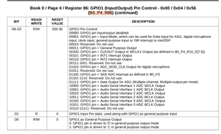

    From your register settings with MCLK1=12.288MHz you should see WCLK1 of 48KHz and BCLK1 of 3.072MHz, did you see that on the scope?
    Your settings are similar to the example in section 4.1.1 of this reference guide except it's slave mode so it should work.
    https://www.ti.com/lit/ug/slau309/slau309.pdf?ts=1676585354030&ref_url=https%253A%252F%252Fwww.ti.com%252Fproduct%252FTLV320AIC3262

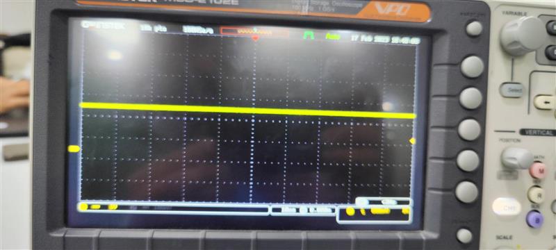

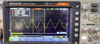

    I tried probing the WCLK and BCLK but I'm not able see any clocks generation on oscilloscope.
    I have attached the snap shot of waveform
    Thanks & BR
    Have you checked MCLK is present in the scope and codec is found as the soundcard?

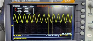

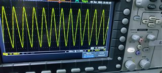

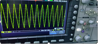

  • Hi Shenghao
    I have checked with AUDIO MCLK, BCLK and WCLK.
    I'm able see the AUDIO MCLK clock waveform on scope as mentioned below
    And not able to see the BCLK and WCLK clock on scope

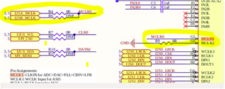

  • Just confirm from you whether all the plots are captured after running the i2c script instead of the code, right?
  • Kindly dump the register during running that i2c script.
    One more thing, there are three MCLK pins, they are mclk1/mclk2/mclk3, which one did you measure?

    We have measured MCLK1 BCLK1 and WCLK1.
    For MCLK1 we are able see the clock on scope. But for BCLK1 and WCLK1 there is no clock signals.

  • Kindly offer book0 page4 register dump
  • Hi Shenghao,
    For Book0 and Page 4 we are setting only below register's
    i2cset -f -y 2 0x18 0x0 0x4
    i2cset -f -y 2 0x18 0x1 0x00
    i2cset -f -y 2 0x18 0x8 0xf0
    i2cset -f -y 2 0x18 0xa 0x24
    You mean we need to set B0_P4_R86_D[6:2] register also ?
    Thanks very much
  • according to the datasheet, it will do.
  • we need set only this B0_P4_R86_D[6:2] register through i2cset ?
    if yes, the value 0x86 is ?

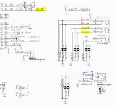

    I have started working on this ticket now, I will share you schematic asap
    Thanks and BR
    Rizwan Chikodi
  • Hi Andrew Jackiw
    I have attached the audio daughter card schematic pdf. please check and let me know anything more needed.
    Rizwan
  • Not able to attach the schematic pdf here.

    • Please check the connections in the schematic. Depending on the software used these would be considered not connected. Although unlikely, please confirm that each color connection is connected in the layout/PCB.

    • Please provide a scope capture of MCLK as requested previously.

    • In PCB all mentioned connection are connected and verified connectivity.

    • We are able see the MCLK1 clock as mentioned above
      • But not able see the clock signal for BCLK and WCLK lines.

    • Im not sure how check square wave form for MCLK1 clock
               We are using dwinstek oscilloscope.

  • Hello Rizwan,
    Thank you for your inputs this far. From your register configurations we expect to see WCLK and BCLK as outputs from the device. Judging from your scope's settings and capabilities, the waveform is represented correctly as a triangle-shaped wave form. At this time, we have two suggestions/recommendations.
    1. MCLK may need to be disabled while I2C writes are configuring the device. Please enable MCLK after the device is fully configured and probe WCLK and BCLK again.
    2. MCLK is not valid, and a more square-shaped wave form is needed for the device to operate correctly. Please provide a MCLK that is a 50% duty cycle square wave to the device.
    Try implementing item #1 alone first and then #1 and #2 together. This will help isolate if the MCLK is the issue.
    Andrew
