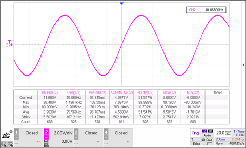

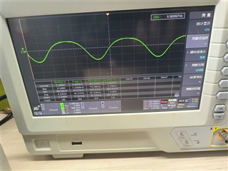

  When I give a 10Hz sine wave input, and the signal is greater than 1V rms, the lower half of the signal will be distorted after passing through the DC blocking capacitor.

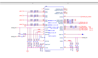

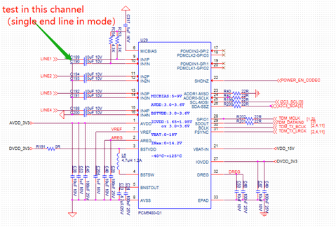

 Here is our design schematic:
After I checked the forum, I found that the micbias needs to be set, so I added a 9V bias according to the schematic design.
The pull-up resistor I currently use is 4.3k, and I found that the waveform is still distorted, and the form is different.
Please provide me some advice.
Thanks for your help.

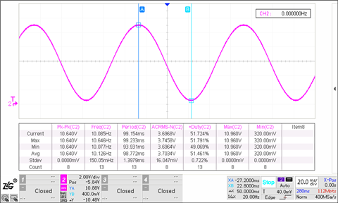

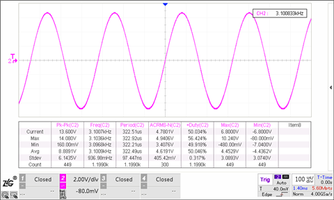

    2. Here is the DC coupling mode image of the oscilloscope: (The AC effective value of the input signal is 3.2V rms)
    3. The layout we are currently using is as follows

  • The following is what I confirmed :
    1I used I2CTool to confirm the register value, and it is exactly the same as written.

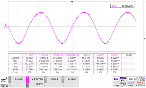

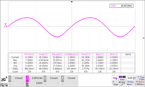

    2The capacitor used in the DC mode measurement has been changed to 22uF, and the resistor connected to the micbias is 1.2k ohms.
    There is no distortion at 10hz at 1V rms input.
    At 3V rms input, the audio starts to be undistorted around 28Hz.
    At 5V rms input, the audio starts to be undistorted around 42Hz.
    In addition, when multiple 22uF capacitors are used in parallel, it is found that the frequency of distortion will decrease.
  • I just found that after changing the resistor connected to the micbias from 1.2K to 15K, using a 22uF capacitor, the 10hz/4.3V sinusoidal input signal is only slightly attenuated and have no distortion.
    This resistor value has far exceeded the recommended maximum value of the PCM6xx0-Q1 AC Coupled Rext Calc.xlsx, so I haven't tried it before.
    Does this finding shed light on problem solving?

  • Here is the scope shot at IN1_P when there is no signal input:
    Here you can see that the voltage on IN1_P has dropped to 5.9V when the 15KΩ resistor is connected to the micbias.

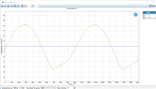

    Here is the shot when I got a 4V rms input (freqrency is 10hz).
  • A Lower DC Level on the pin impacts the maximum signal we can apply on the pin.
    5.9v DC Will mean a Maximum signal of 5.9/1.414  or 4.17 VRMS will work.
    If this OK for your application, then 15k should be fine.
  • I'm currently considering 12KΩ , 22uF, 9V micbias. This setting can make the IN pin voltage reach 6.24V ( Maximum signal 4.41V rms), and the attenuation at 10Hz is 0.6dB. This is enough for my application.
