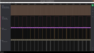

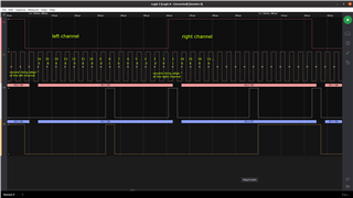

1) Our TLV320AIC3100 is connected to STM32F4 MCU with SAI configured as I2S. DIN => DAC => speaker is producing proper sound without any noticeable artifacts. MIC => ADC => DOUT however is producing rubbish and I can barely make sense what has been sampled. To debug this problem, I enabled DIN to DOUT loopback and disabled MIC & speaker. After inverting BCLK (page 0, register 29, bit 3), DOUT data started to look somewhat similar what was fed to DIN.
Here's a register dump. Rest of the registers are unmodified.

BCLK and WCLK frequencies.
Logic analyzer settings.

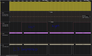

Feeding 1,2,3,4,5... to DIN and reading it back from DOUT. BCLK is inverted here. You can see that ch2 is (ch1 - 1) "behind". To me this seems like an alignment issue because on TLV320AIC3100 ch2 should equal ch1 (mono audio). Can you spot what's wrong?
