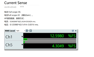

Could you clarify how we should read the data Isense, Vpred and Aux Ch1-4, on SDOUT in TDM config?
How can we convert it in Amperes and Volts? is there a ratio to apply?

       The detailed setting method is as datasheet 8.3.2.5.2 says. TAS6584 will put the value in every audio slot under TDM mode. Below table shows the sequence. You could read each audio slots data, and use them to transfer to real value.
       And below picture shows the ratio for Vpredict and Isense.
