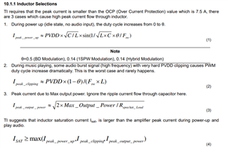

  • Hi Peter,
    You can roughly estimate the current flow through PVDD by the equation: I ≈ Vpvdd/Rspeaker. And if you want to calculate  more accurately, you can refer to equations from TAS5825 datasheet as below because Ipvdd is equal to current flow through inductor.
